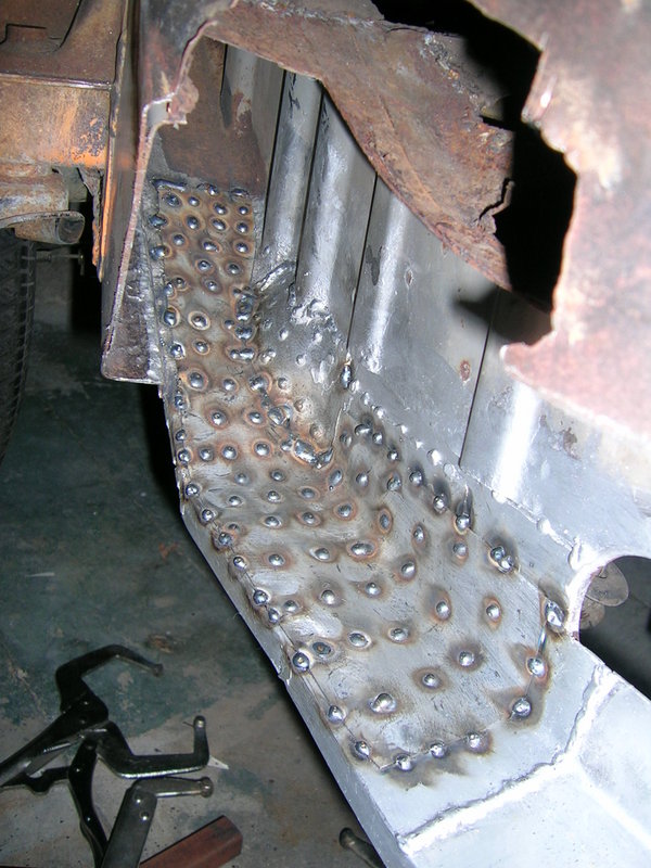

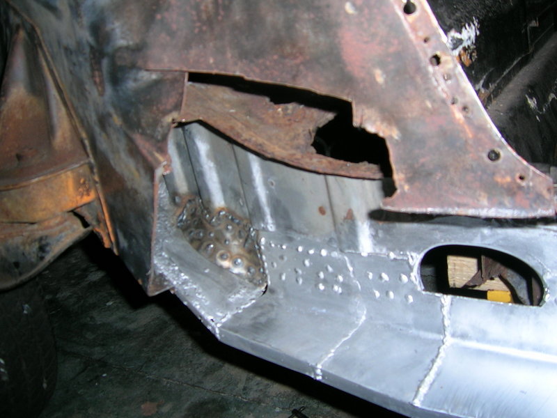

Hell hole? Hell no!
(IMG:http://i19.photobucket.com/albums/b188/type11969/914/pic002-5.jpg)
Also cut out rust due to the battery tray and welded a new chunk in:
(IMG:http://i19.photobucket.com/albums/b188/type11969/914/pic006-4.jpg)
Well damn, its been a long time since that long was whole, hopefully repairs start going faster now . . .

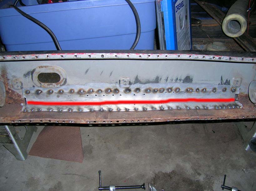

You have marched this far into hell so far- Heaven can't be far. I would pull the welds on the rear floor and open up to reinforce the longs on the inside or else you have just a reinforced hinge waiting to happen. Or add an Engman kit. I would also double up on the metal at the inner long to inner wheelhouse location. This is a high stress area and leafing new metal in is not very strong. Your welding skills look great and you on the right track.
Do not give up. You will regret it if you do....

I have an engman kit, but I'm not following where you are suggesting to reinforce regardless. I don't think I can reinforce the longs anymore on the inside (nor do I think they can be opened up any more than I had them!), all rusty metal has been removed and at least the (if not more) than the factory thickness of material, doublers, etc was reinstalled. Inner long to inner wheelhouse section, are you speaking of the area where the heater tube passes from the engine bay into the long? That area was doubled, maybe the pics aren't clear. Please elaborate if you can!

QUOTE(type11969 @ Oct 12 2007, 06:19 AM) *
Lou, thanks!
Jeff-
Thanks,
Chris
Chris,
This will teach me to open my mouth before I read the entire thread. I take everything back. I only saw page 1 and I will take foot out of mouth now.
You are doing great. Your car looks like mine.
What I was referring to and then the site went down about an hour ago as I was about to hit "add this" was this photo. I saw two tracks of plugs and nothing in the corner. That was my reinforced hinge comment (in red). Then after reading your progress and install of the Engman I ran for the hills. My bad.
The layering (leafing) was the next photo. Its hard to get the right shape of lower long and I thought you didnt have enough meat in there.
Then I inserted foot in mouth again when I saw the next progress photo which I thought was outstanding.
The lesson of my day was to keep quite and read the whole thread. I didnt realize were so many pages and jumped the gun. Your work is awesome. You have great fab and welding skills. You clearly have gone overkill which I always do. Your car will NEVER sag EVER and probably outlast us all.
When I update my thread I will let you take some payback shots for fun.
