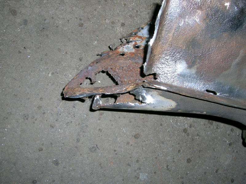

Couldn't find any pics of the lovely riveting and brazing job a PO did with re-attaching the portion of the fender below the sail, but I hacked that focker off:
(IMG:http://i19.photobucket.com/albums/b188/type11969/914/121304002.jpg)

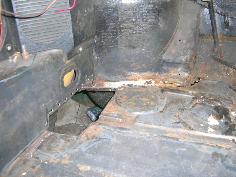

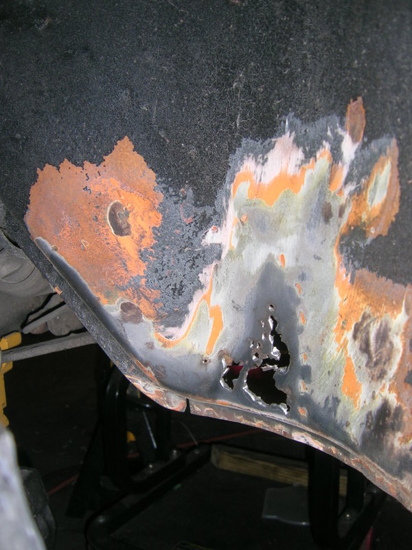

Also found after removing the interior that the passenger side was once used as a pool, the entire lower inner corner of the long and bulkhead was gone. PO crappily arc welded a new floorpan in, but didn't fix any of the other damage:
(IMG:http://i19.photobucket.com/albums/b188/type11969/914/Picture069.jpg)
(IMG:http://i19.photobucket.com/albums/b188/type11969/914/Picture070.jpg)
(IMG:http://i19.photobucket.com/albums/b188/type11969/914/Picture071.jpg)
(IMG:http://i19.photobucket.com/albums/b188/type11969/914/111404002.jpg)

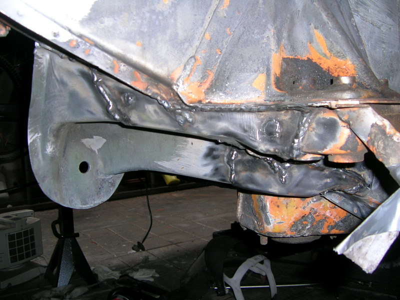

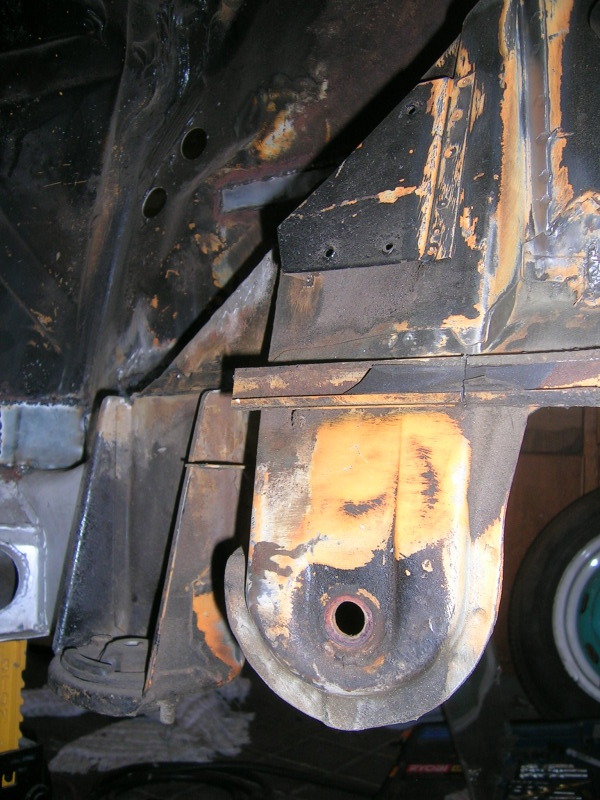

type11969   tacked http://i19.photobucket.com/albums/b188/typ...   Jan 10 2007, 07:54 PM
McMark   Looking good! :thumbsup: Watch out for warpa...   Jan 10 2007, 10:50 PM
type11969   Looking good! :thumbsup: Watch out for warp...   Jan 11 2007, 07:05 AM

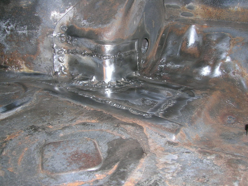

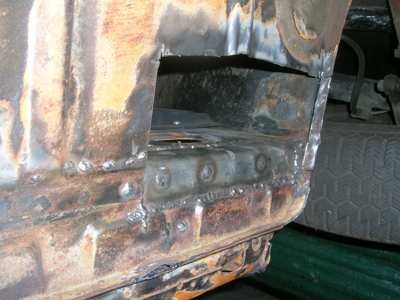

type11969   Sadly the weekend was mostly a waste, got a little...   Jan 16 2007, 09:56 PM

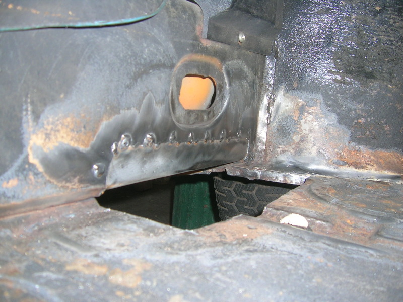

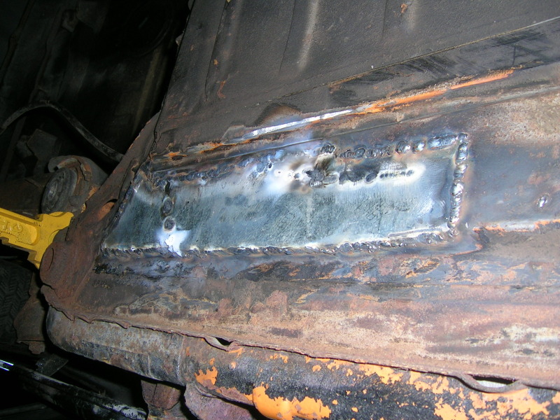

type11969   Things weren't going my way today. Welds kind ...   Jan 17 2007, 09:52 PM

type11969   Thanks for the kudos, hopefully it is as strong as...   Jan 18 2007, 07:11 AM
dkos   Thanks for the kudos, hopefully it is as strong a...   Jan 27 2007, 11:30 AM

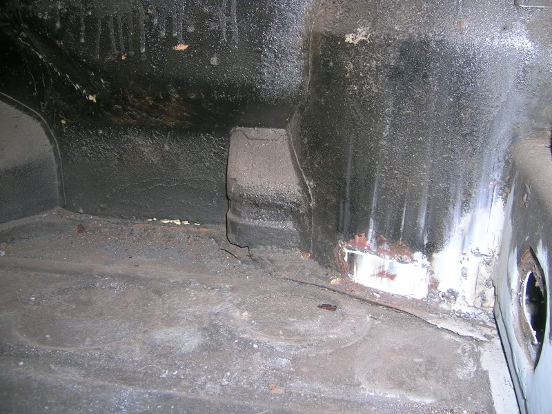

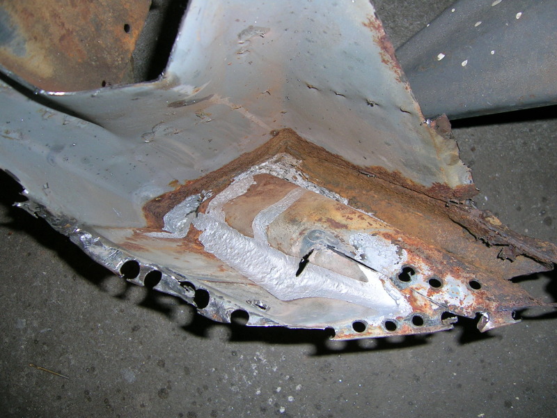

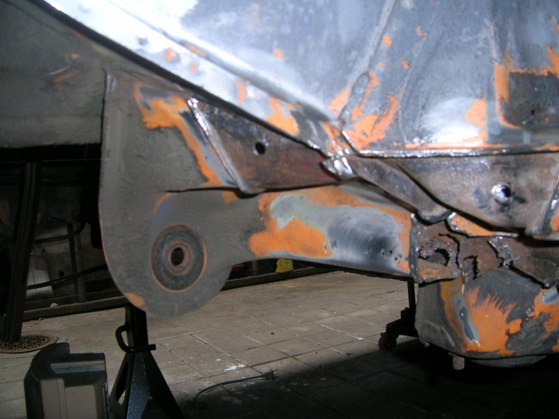

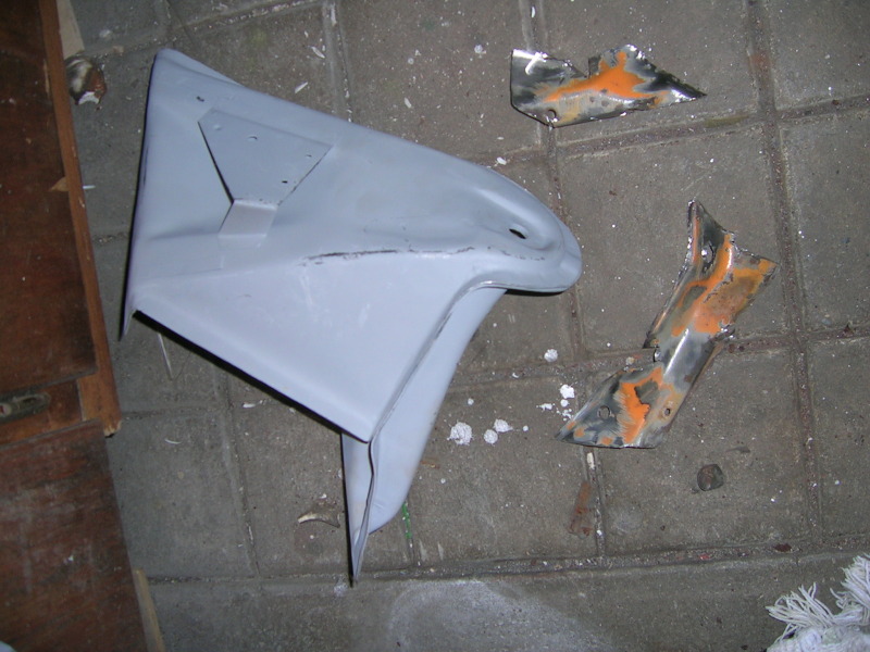

dkos   Here are some pics of the Brad Mayuers piece. Top ...   Jan 27 2007, 11:33 AM

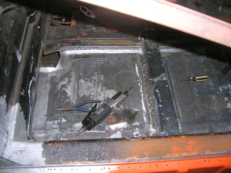

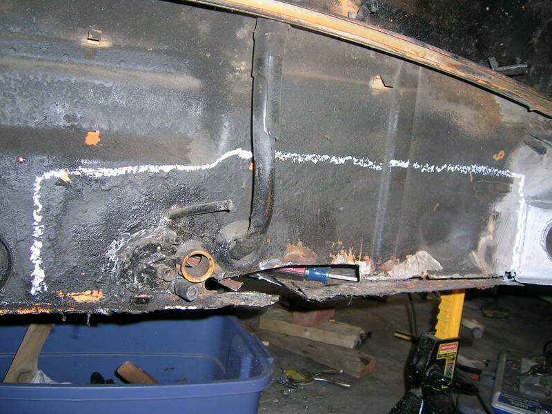

type11969   Got a little done this weekend. Ground some welds ...   Jan 22 2007, 08:05 AM

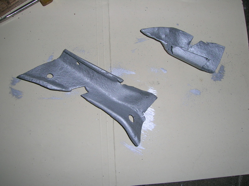

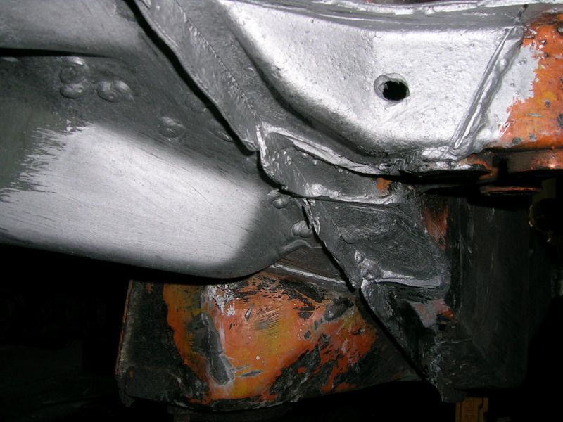

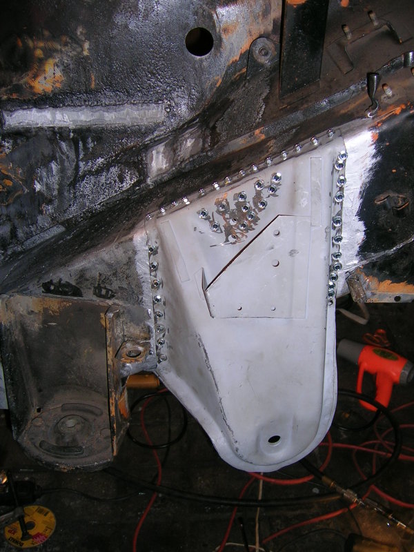

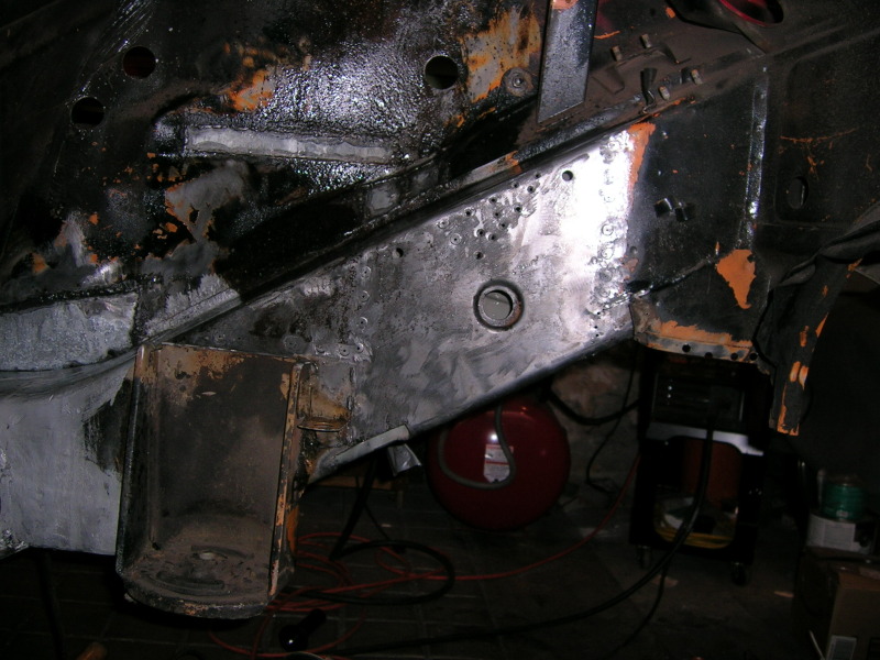

type11969   Some more progress, piece fabbed: http://i19.phot...   Jan 24 2007, 09:40 PM
dkos   how it attaches   Jan 27 2007, 11:59 AM

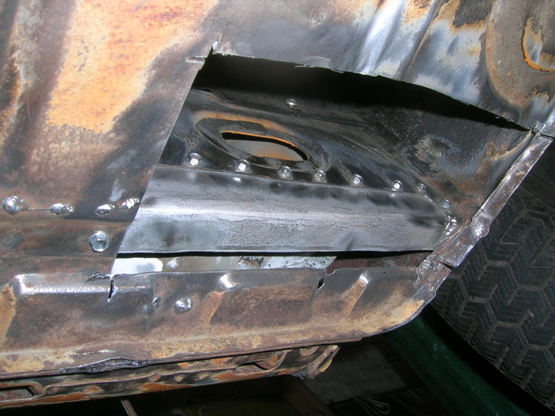

dkos   Chris, The reinforcement piece welds in along the...   Jan 30 2007, 08:27 AM
dkos   My car was in similar condition to yours.   Jan 30 2007, 08:29 AM
dkos   I ended up cutting away all that rust and recreati...   Jan 30 2007, 08:51 AM
type11969   I ended up cutting away all that rust and recreat...   Jan 30 2007, 11:22 AM
dkos   I ended up cutting away all that rust and recrea...   Jan 30 2007, 11:30 AM

dkos   My intitial plan was to also fabricate the inner r...   Jan 30 2007, 09:19 AM
dr914@autoatlanta.com   My intitial plan was to also fabricate the inner ...   Jan 30 2007, 09:24 AM
dkos   My intitial plan was to also fabricate the inner...   Jan 30 2007, 09:36 AM
dr914@autoatlanta.com   [quote name='dr914@autoatlanta.com' post='856081'...   Jan 30 2007, 09:53 AM
type11969   Fortunately my driver's side seems sound right...   Jan 30 2007, 11:37 AM
dkos   Fortunately my driver's side seems sound righ...   Jan 30 2007, 11:45 AM
dkos   some pics   Jan 30 2007, 11:40 AM
dkos   more:   Jan 30 2007, 11:41 AM

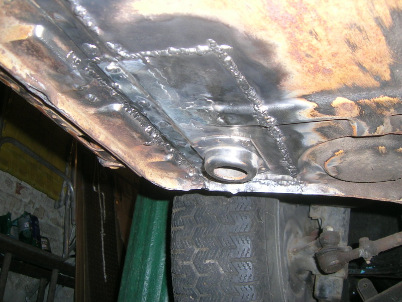

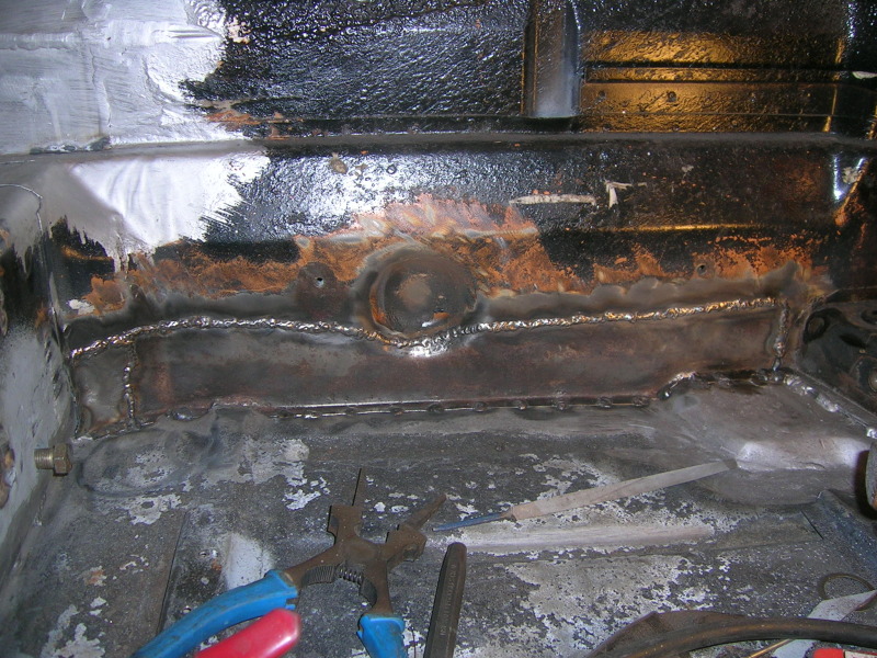

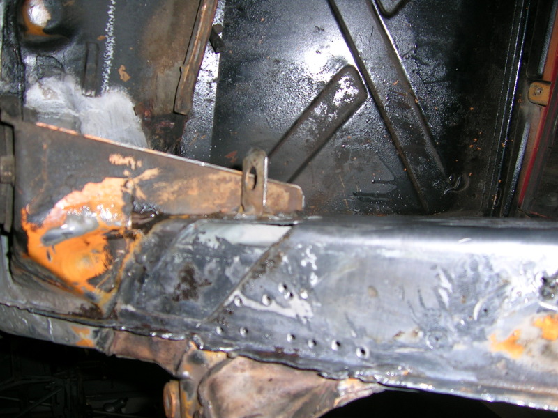

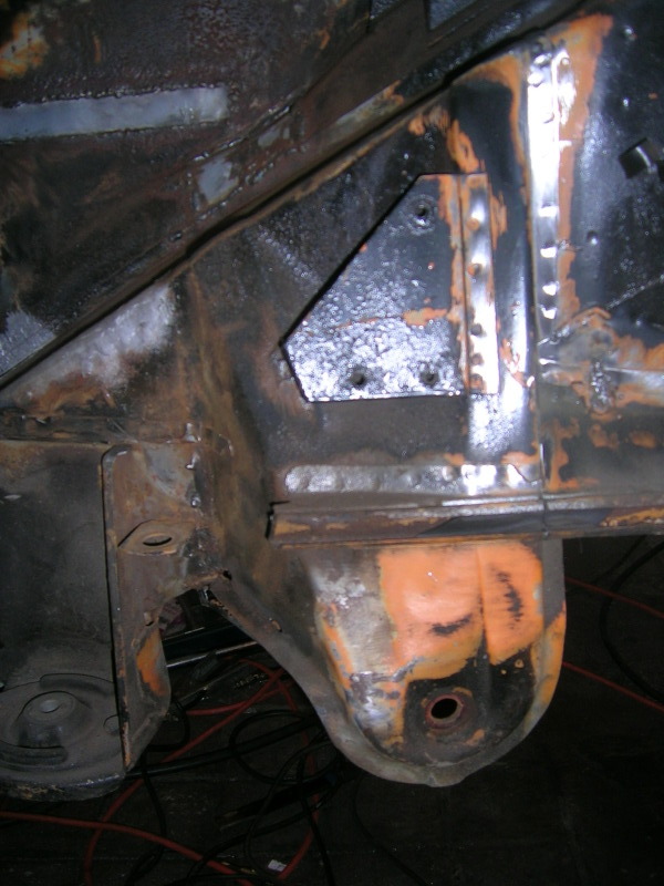

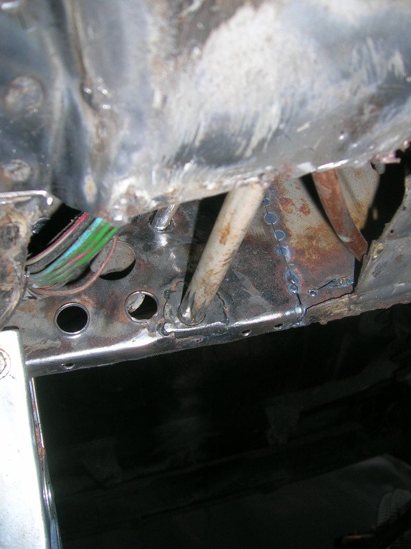

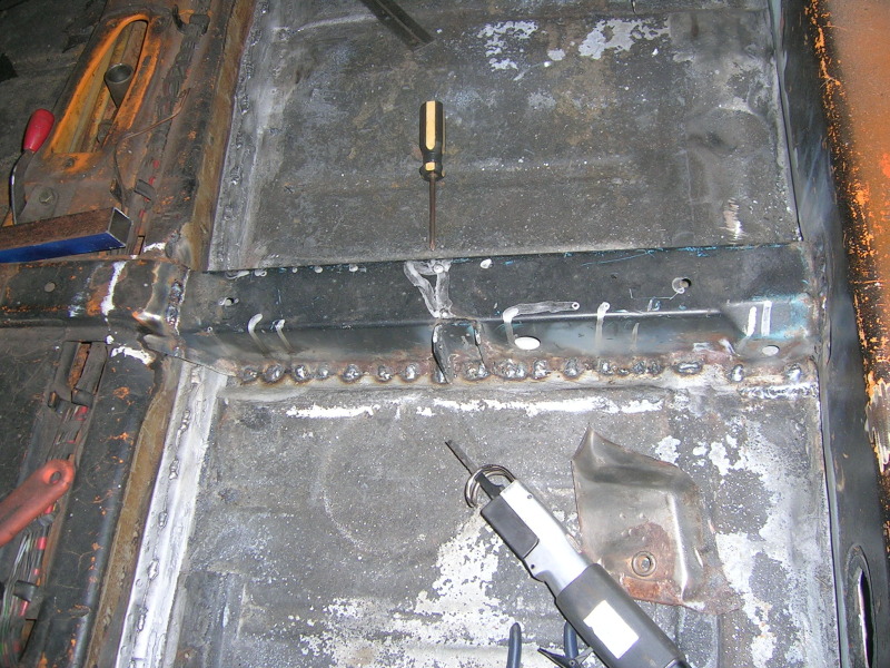

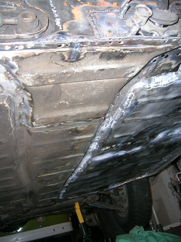

type11969   Heater tube sheet metal tacked in: http://i19.pho...   Feb 6 2007, 09:25 PM

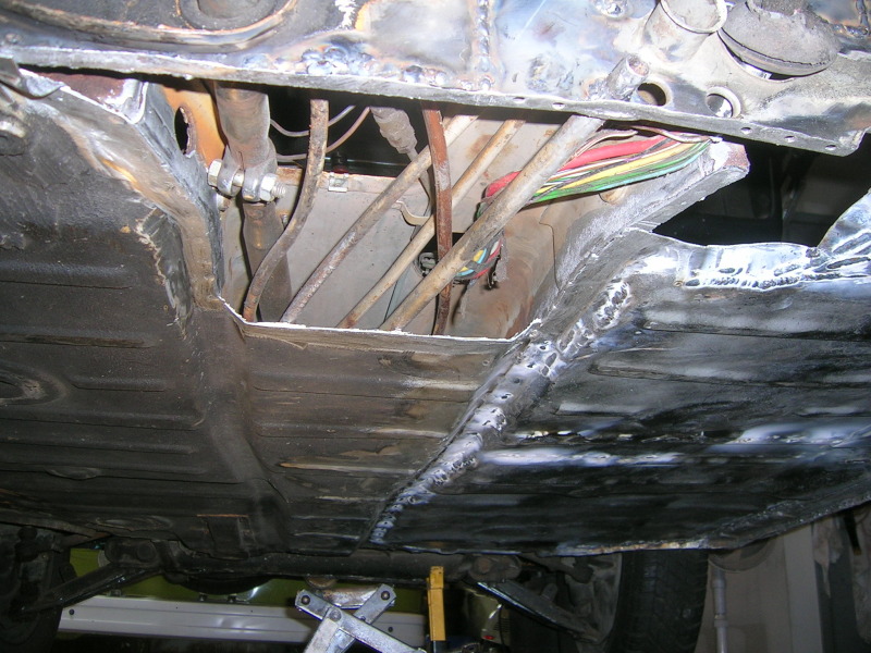

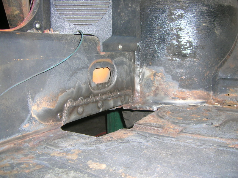

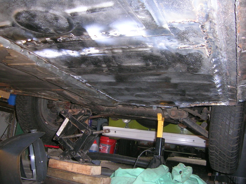

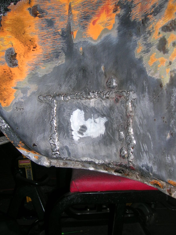

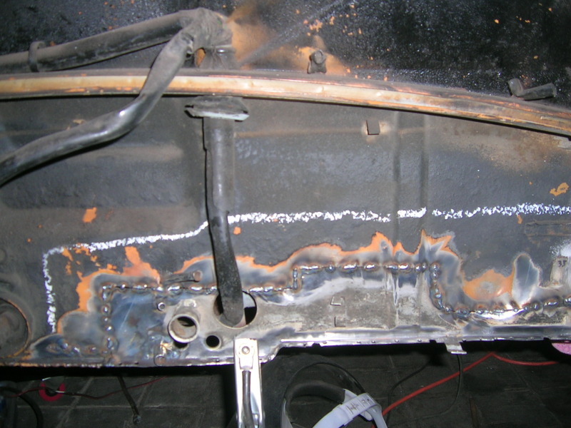

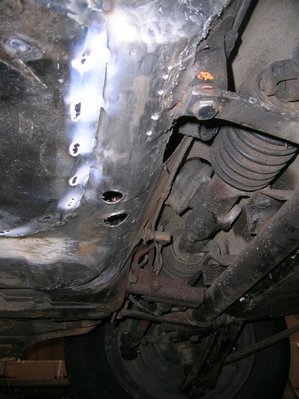

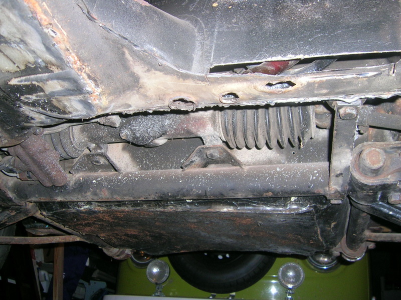

type11969   After a rough, but entertaining weekend, I've ...   Feb 12 2007, 09:20 PM

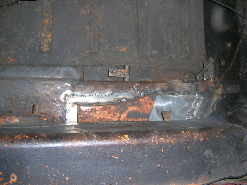

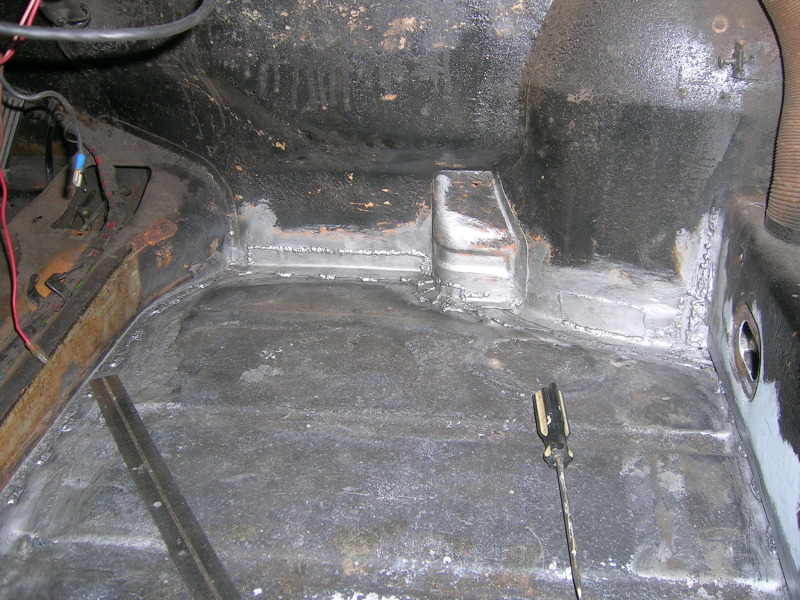

type11969   Got a little work done here and there over the pas...   Mar 19 2007, 08:01 AM

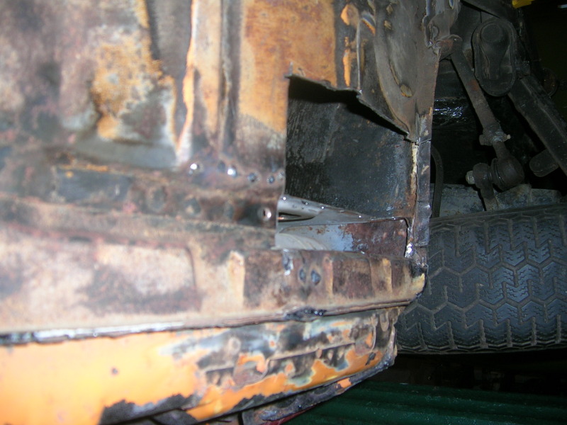

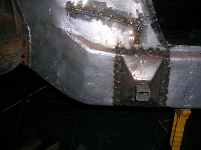

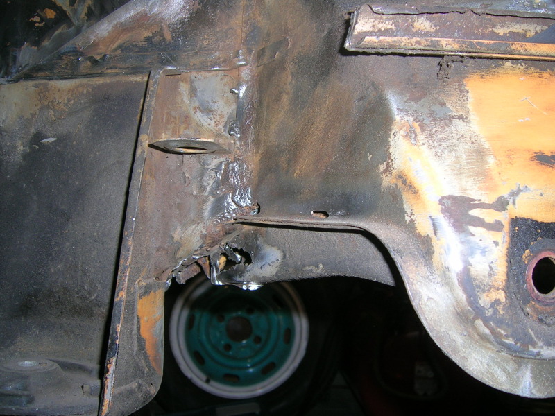

type11969   Inner rocker on: http://i19.photobucket.com/album...   Mar 25 2007, 09:18 PM
