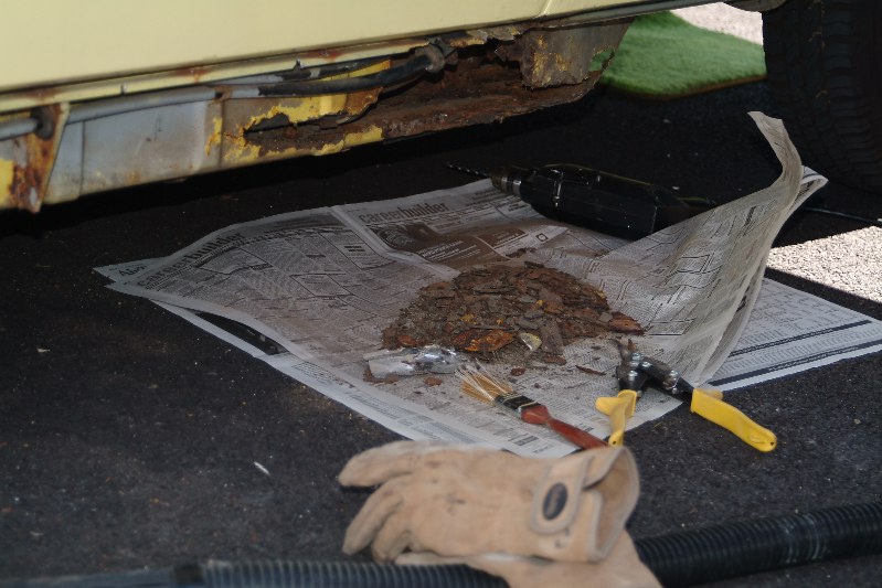

QUOTE(dkos @ Jan 30 2007, 06:51 AM) *
I ended up cutting away all that rust and recreating the inside and bottom of the long. The piece I made wraps around the top inside of the long. Unfortunately I don't have a pick from the inside of the car.
Dave-
That looks really good, definitely puts my fab skills to shame! I can't believe your driver side long looked like that though, what kind of shape was the pass side in? Definitely looks plenty strong though, but the extra outer layers certainly can't hurt! Where are you in Philly? I'd like to check your car/progress out at some point. JerryP is in the area too, maybe we can all get together at some point. It seems we all have the same rusty 914 repairs.
-Chris

QUOTE(type11969 @ Jan 30 2007, 12:22 PM) *
Dave-
-Chris
Thanks for the kind word...pics look beter than the real thing. I'm working on the passenger side now...it's in similar shape.
I was clueless when I bought this car. The PO had fiberglass rocker covers on the car hiding all the rust. I didn't know enough to look under them.
I live in Flourtown, just west of Mt. Airy...outside of Philly a few miles.

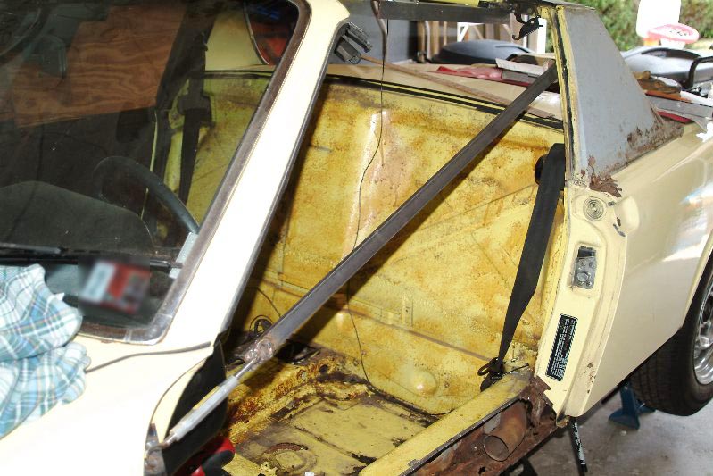

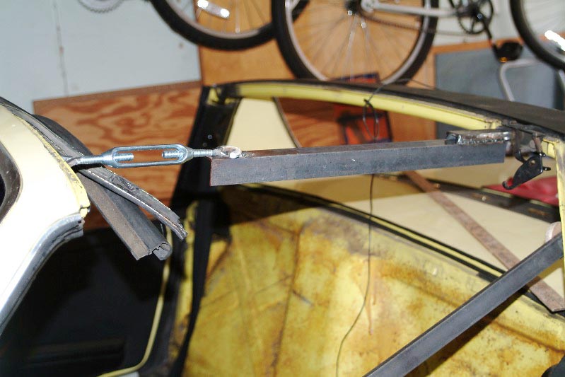

Fortunately my driver's side seems sound right now . . . Have you braced your car at all? My biggest worry is that when I am all done, the car will be all warped out of shape. Hopefully the bracing I have fabbed will mitigate that.

QUOTE(type11969 @ Jan 30 2007, 12:37 PM) *
yep!
