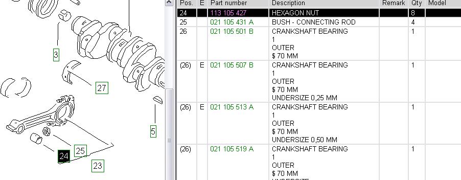

Just wanna make sure they are correct...
My PN is the same as the chart below. Right ones ??
BTW, its the bolt, NOT the bushing (IMG:style_emoticons/default/wink.gif) (see pic)

Yea, and I guess I have NUTS, not BOLTS.
Sorry Bern...
