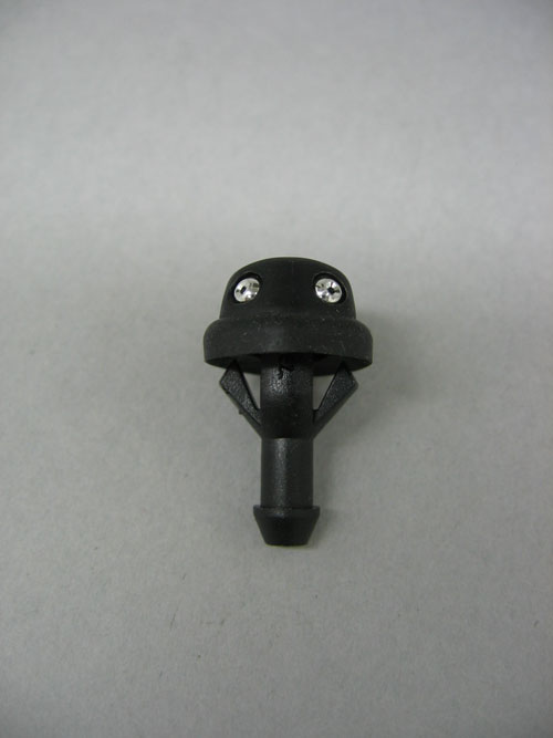

How do you get the washer nozzles off of the cowl? My car is a '74.
My '72 & '73 cars have the chrome top type and the part that sat on the cowl was rubber. Just squeeze the rubber together from the under side and they came out.
These seem to have some kind of nut holding them on? Don't want to take the pliers to them and ruin the whole thing.
Appreciate the help and suggestions.

i'm building a '74 race car right now. couldn't figure out how to do this without destrying them. so i snipped the bottoms off, grapped ahold of the tops with vise grips, and just worked 'em out.
they're ruined now, but removed!

As I recall, there are two ears that expand once through the hole to lock it into the hole.
To remove, pinch the two ears together and work it up through the hole. I have removed these without destroying them. A pair of needle nose pliers helps to squeeze the ears together.

I just removed mine from my '74. I used needle nose pliers and squeezed both ears gently and pushed up. One ear came up first (kind of on an angle) and then the other. Both of mine were clogged. I used a very small drill bit in my hand and eventually cleaned them out. It appears the actual jet is aluminum.
