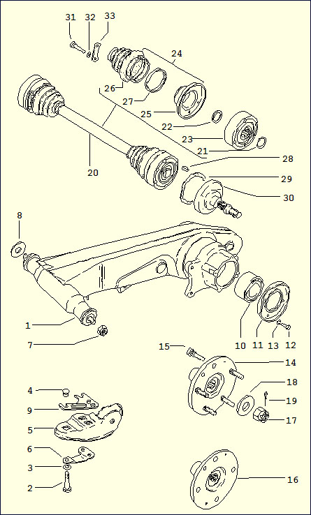

alpha434   How do I get the cv off the wheel hub? The bolts a...   Jan 31 2007, 01:58 PM
Brando   The CV bolts are on the inboard side of the wheel....   Jan 31 2007, 02:20 PM
Lawrence   I'm not sure how you know it's the circlip...   Jan 31 2007, 02:25 PM
alpha434   Yeah. Thanks, Brando. The mount itself should be ...   Jan 31 2007, 02:28 PM
Brando   Chris, this should help some:   Jan 31 2007, 03:16 PM
alpha434   Perfect. Thanks. It's 18 degrees outside!   Jan 31 2007, 03:20 PM
