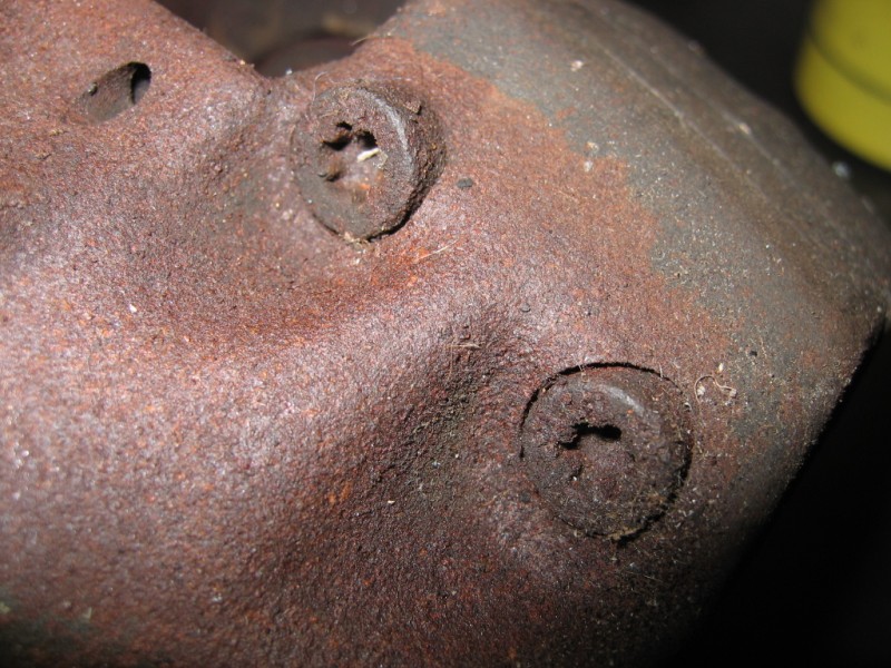

#1 - These have the 911 M-Caliper hardware for sure. The first thing I noticed was the Ribe head cap screws with the R6 head. This differs from the rounded shoulder Ribe R5 hardware used on the 914-4 and 914-6 calipers of that era.
#2 The next thing I noticed was the spacers. These are the round shouldered spacers from an early rear M-Caliper of that era. Later GT and Ferrari calipers have sharp or squared off spacers that better match the caliper mating surfaces.
#3 The final note (of distinction) for the rears would be the color. It seems as though these are definitely "yellow" cad plated. On other 914-6 calipers it was difficult to tell because they were so light. When we tear into them we can usually see some yellow on the mating surfaces but, again, it's very light in color. These look to be 914-4 yellow in color, meaning; very obvious.

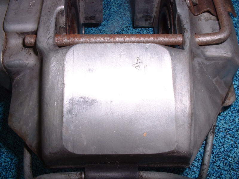

Now for the fronts...

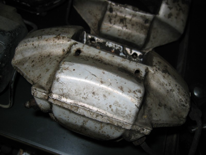

S-Calipers. Early S-Calipers.
Most S-Calipers have the rounded off bull nose. These S-Calipers have a more squared off nose with little casting wings on them.
Here's a shot of a bull nose S-Caliper side-by-side for comparison:

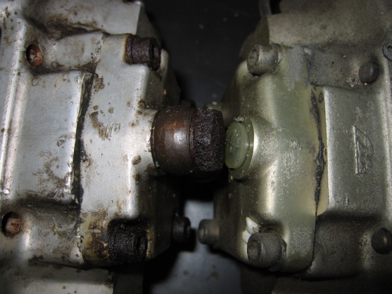

Notice anything else? How about the color? Again, most S-Calipers have a greenish gold tint from a sealer used in the anodizing process. These early calipers are simply anodized aluminum. Here's another side-by-side for comparison. 914-6 #11 on the left, later model S-Caliper on the right.

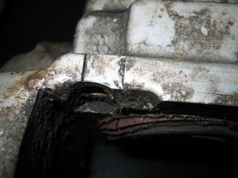

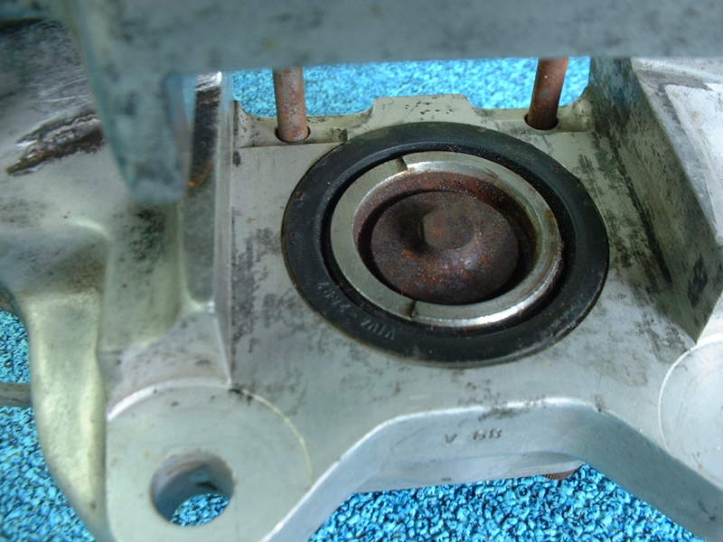

Here's some wierd notches that I'm still scratching my head over. These are just on the left caliper... anybody? (IMG:style_emoticons/default/confused24.gif)

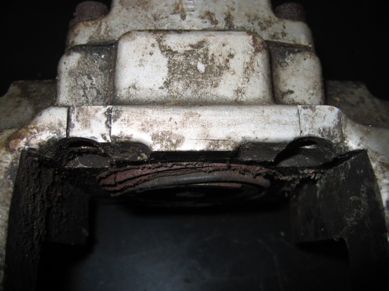

One more showing both...

Maybe they were a prototype that got changed along the way? Maybe they were borrowed from some other European car model on short notice?

Are you talking the S-Calipers? I don't think so. They should have had S-Calipers as standard equipment the previous year on all 911S's. Only the left caliper has those notches... (IMG:style_emoticons/default/wacko.gif)

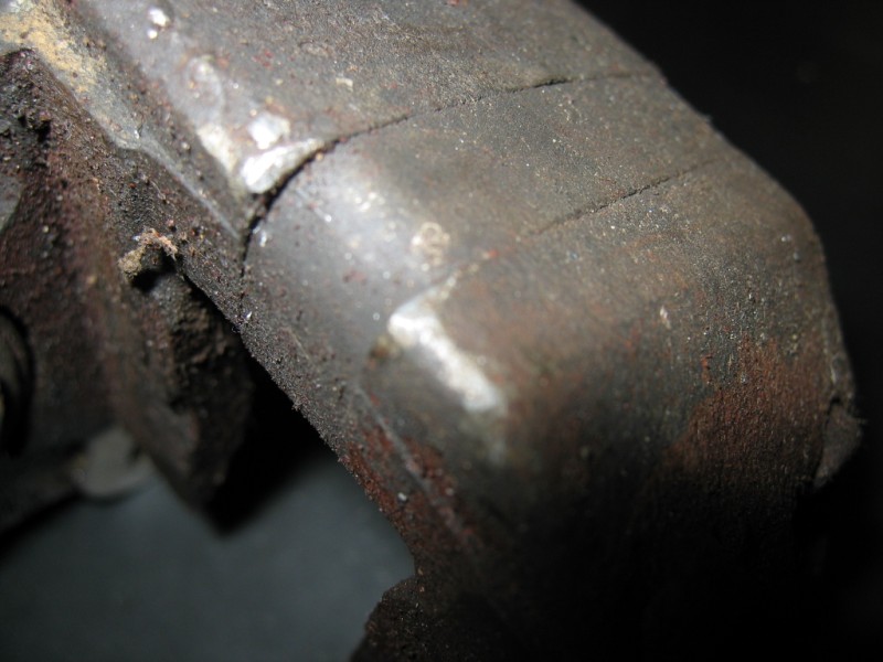

I dug into the first S-Caliper this evening... man, talk about bad shape. Don't leave your cool historic Porsche sitting in a barn. Everything came apart OK though. It was a task. Pics tomorrow.

I found another S-Caliper with the casting wings "but" it was post 1971. If you look at the second picture in post #3 you'll notice two circles on the top of the later caliper on the left. Inside those circles is stamped an "X". While looking at the factory manual this denotes a new piston and a date range later than 1971 (I believe... manual not in front of me at the time of this writing). I found one of the early style calipers (wings) with the circles cast in it and the X's... (IMG:style_emoticons/default/idea.gif)
A pockect for the keeper. so the pad can retract further. 1.5 extra pad for endurance racing. or as stated protype , fittment issues

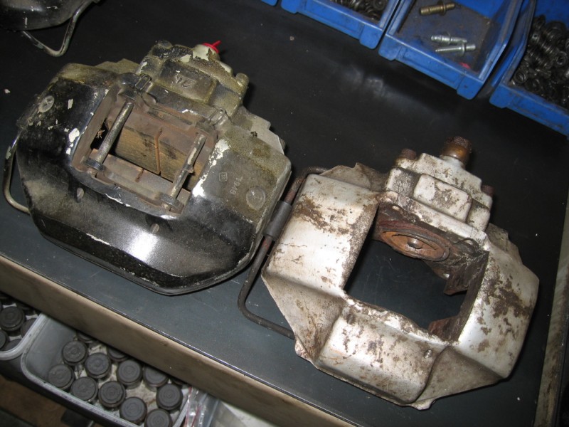

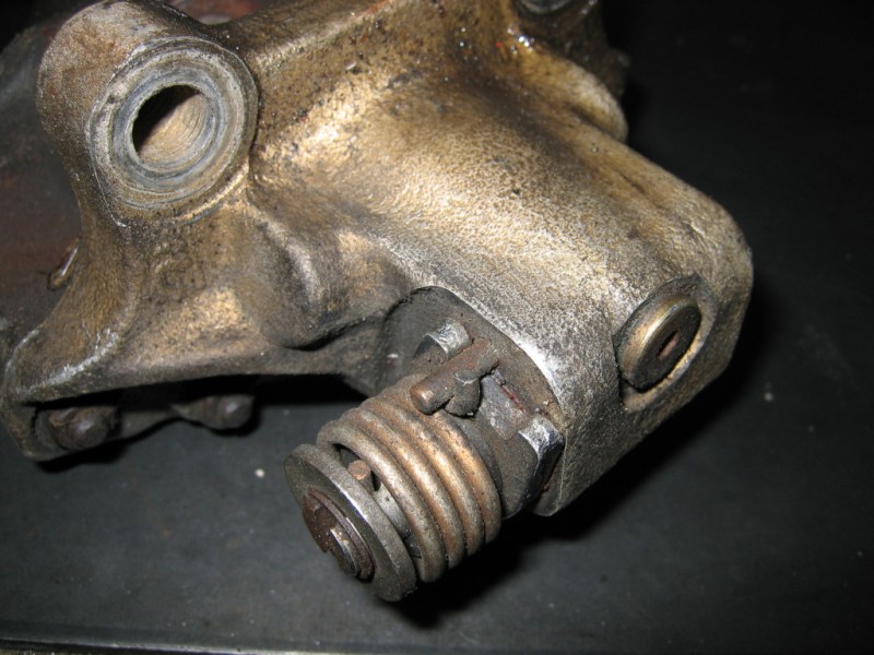

here is my oddball caliper
Eric_Shea
post Feb 14 2007, 03:49 PM
PMB Performance
Posts: 19,304
Joined: 3-September 03
From: Salt Lake City, UT
Member No.: 1,110
908?
