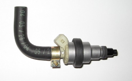

Bleyseng   So again Pat, why do they have tobe fabric covered...   Mar 7 2007, 09:17 PM
Pat Garvey   So again Pat, why do they have tobe fabric covere...   Mar 8 2007, 06:34 PM

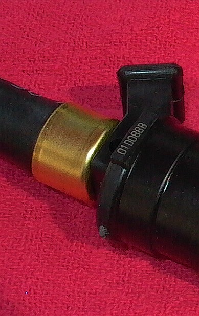

jk76.914   Pat, how are you reproducing that crimp-on clamp t...   Mar 8 2007, 11:37 AM
Bleyseng   you can get those crimp clamps if you want to be ...   Mar 8 2007, 01:06 PM
jk76.914   you can get those crimp clamps if you want to be ...   Mar 8 2007, 02:34 PM
Bleyseng   Thats only at the injector supplied by Bosch. The ...   Mar 8 2007, 05:23 PM
jk76.914   Oh. I get it. I'm still wondering how Pat is...   Mar 8 2007, 05:44 PM
Bleyseng   I knock off a few points "if" I were jud...   Mar 8 2007, 10:04 PM
Pat Garvey   I knock off a few points "if" I were ju...   Mar 9 2007, 09:24 PM

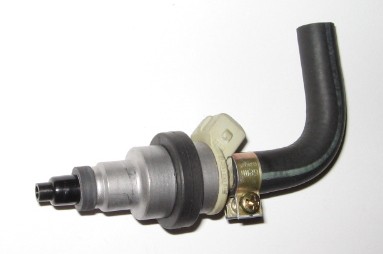

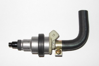

Bleyseng   Here are the OEM fabric injectors for a 2.0L and a...   Mar 9 2007, 09:29 PM
Pat Garvey   Here are the OEM fabric injectors for a 2.0L and ...   Mar 10 2007, 08:07 PM
jk76.914   Here are the OEM fabric injectors for a 2.0L and...   Mar 10 2007, 09:47 PM
