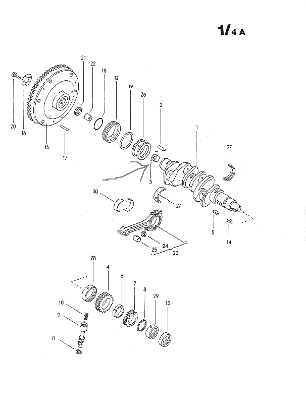

1.) If you change flywheels, you should check crank endplay. You could chance it and just swap it. Make sure the shims on the crank behind it are in place.

Yes flywheel will fit, you need to make sure you check the end play on the
crank and add or subtract shims as needed. Replace the crank seal, output
felt and use new bolts for piece of mind.

1. Yes the 1.8 Flywheel and clutch are the same as the 2.0 parts. You can balance the flywheel with the crank, but typically they are balanced alone.
When shimming the flywheel, there are ALWAYS a total of 3 shims. Never less and never more.

So where does this spacer (#3) fit into things. I never see anyone mentioning this spacer.
