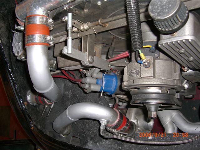

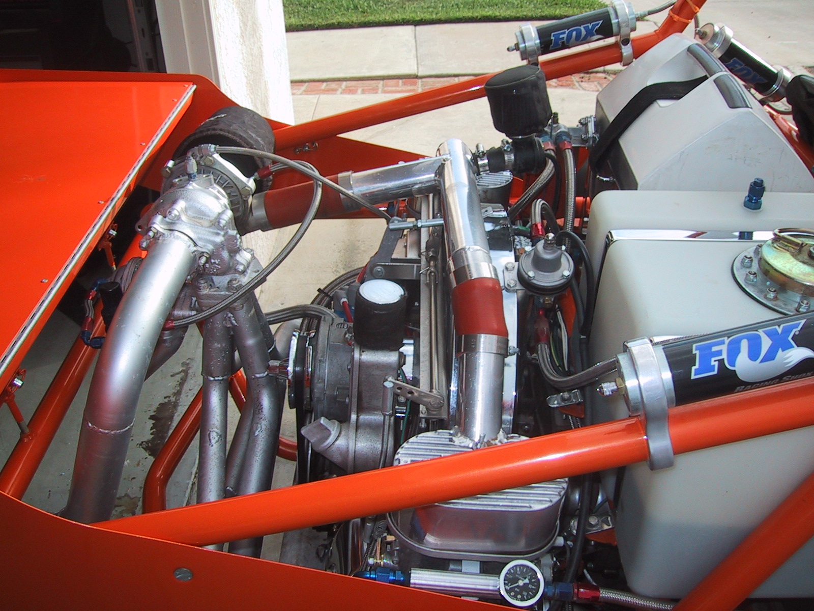

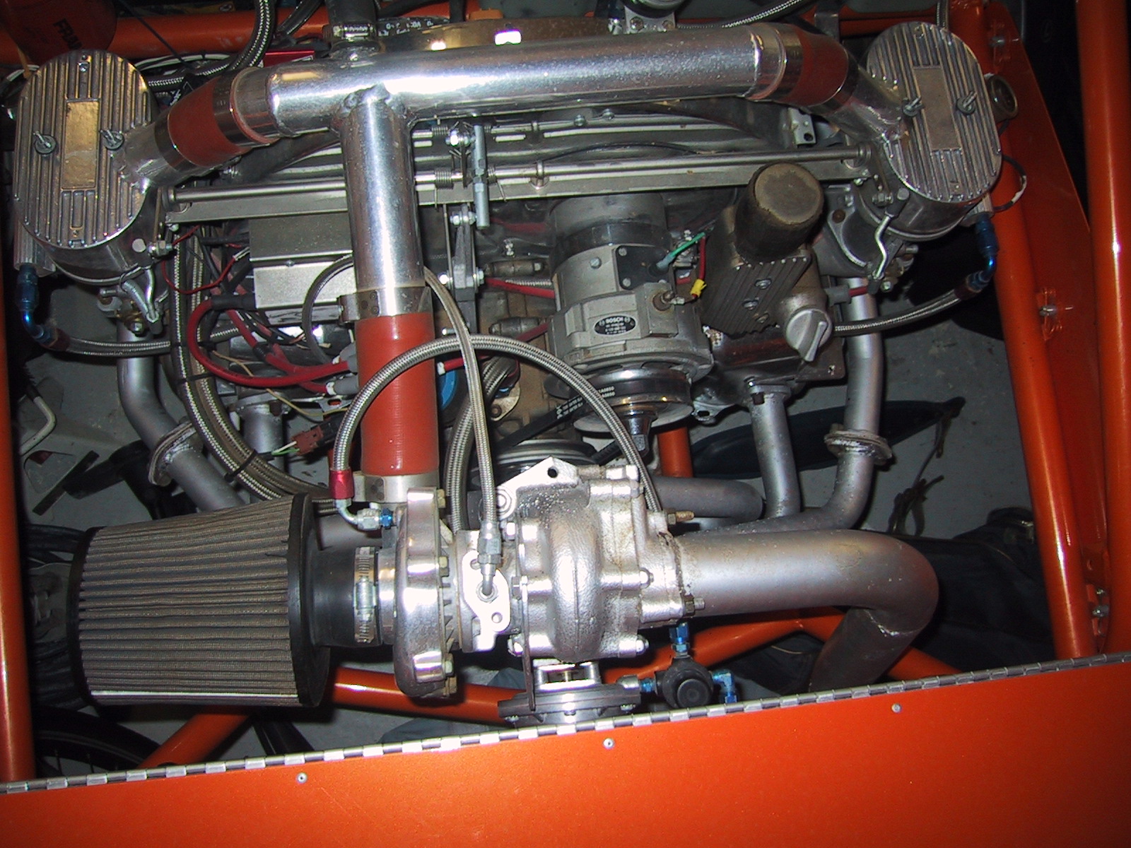

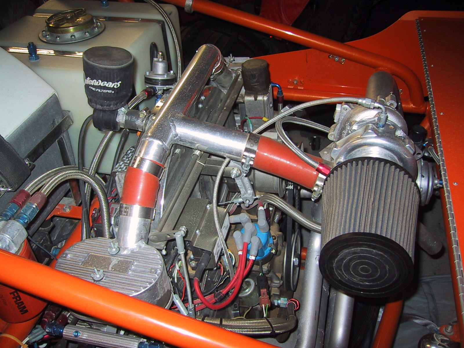

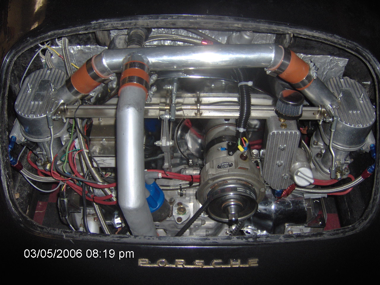

mikez http://www.cbperformance.com/images/RedEngine.jpg
... Feb 10 2007, 04:40 PM
mikez Same engine but with single turbo mounted up top i... Feb 10 2007, 04:58 PM
