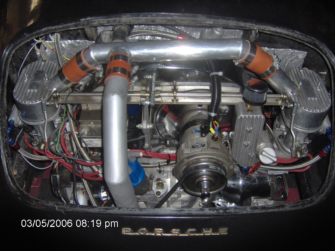

IPB Image
Turbo street Type I....
Similar to what I have in my 356 replica....
Then I added an intercooler in the wheel well.
Joe Bob

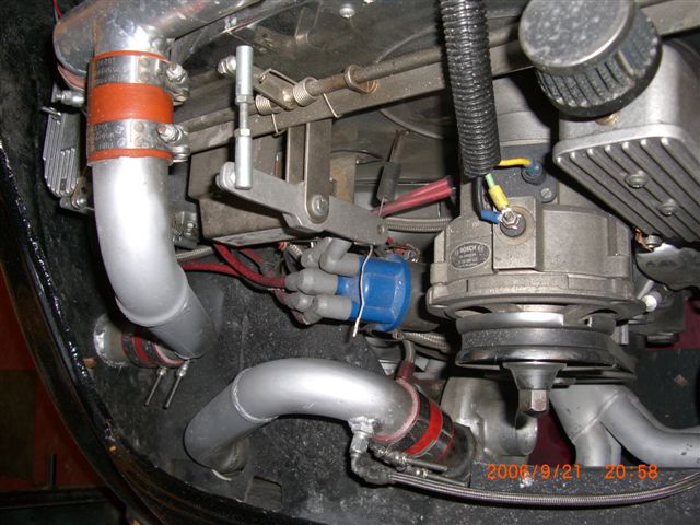

Same engine but with single turbo mounted up top in a sandrail...
