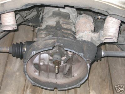

Is this really a 915 transaxle....Wanna get one for a V8 Conversion....not sure how to identify one and tell the difference between a 915 and the 901 that comes in these cars....?

this is surely no 901 Transmission. Completely different throw out arm. The 901 has a "fork" like a streched Y.
Maybe this is a 915 or g50 trans (IMG:style_emoticons/default/confused24.gif)

The case halfs should have stampings on the side starting with 915.---.---. Also clean the ridge on the bottom of trans and get the production number it will tell you. I may be wrong but the 70-71 911 trans were called 915 trans also but they have a different clutch arrangement.
It's actually called a 911, but that gets so confusing in itself.
That picture at the start of the thread may be an early 915. It's hard to tell. Look at the strengthening ribs on the 915 and 930 that Bill posted. Also, what's it sitting in? If it's a 72 or later (up to 87) 911... it's a 915.
