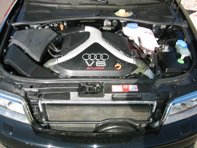

speaking of the Audi S4 motor, the 2.7 Twin Turbo 6....
that 500hp motor that Sportline (?) had on display at the German AutoFest looked
really small.
I mean, it just don't look very big, ya know!?!

At the moment I have both an 2.8 A4 and Biturbo S4 and visually the S4 engine looks smaller the bock is very short. The whole block sits in front of the centerline of the front wheel.
I think the Biturbo would definitely but I think the 1.8 turbo from a TT would be a better solution, chipped with exhaust ~250 HP.
