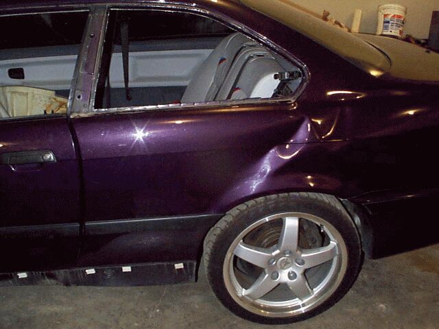

Dude,
Love to color! (somewhere in my youth I drove a plum purple '70 Demon) Dent looks a bit awkward, tho it's hard to tell from one pic -- you pulling to straighten? (man, there's phrase we don' t use out here too much (IMG:style_emoticons/default/laugh.gif)) Progress pics would be cool!

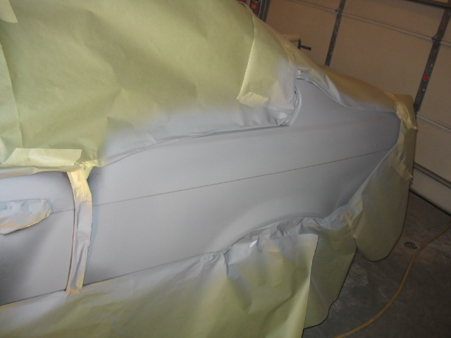

Ok. I type, and then you type. Otherwise it gets messy.
Second pic looks very nice tho.

Believe it or not the damage was caused by the car landing on top of a boulder. The drivers side floor pan was pushed up. And the quarter panel was bend out about 3". The buckles are from pressure. The door is latched in the before picture. gap was about 3/4". Clicks shut with one finger now.

Rich,
You didn't have to pull it? Did straightening (pounding/whatever) back on the floor pan supply enough pressure?

I did a down pull at the same time as I pulled the panel back in from the passangers side. I have anchors in my garage. I set the car over one of the anchors under the left "B" pillar. I hooked a chain to the anchor then to a 3" wide strap. The strap went up across the rocker, inside the car, around the "B" pillar, through the passenger door, to a 10 ton ram. As I pulled the panel in, I was also pulling it down. I slid a few pry tools insde the panel and poped the damage out. Saved the factory panel with the door jamb serial number. Good days work I'd say.

QUOTE(rich 918-S @ Nov 23 2003, 10:50 PM)
This makes perfect sense. (and is indeed a good day's work!) I am always surprised at how well the right moves in a body shop can make ugly damage "go away". It looks great from here!
