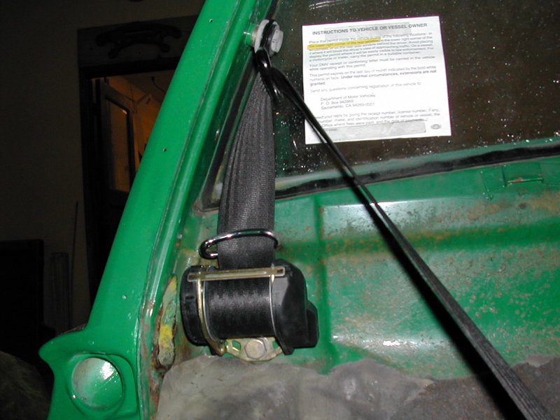

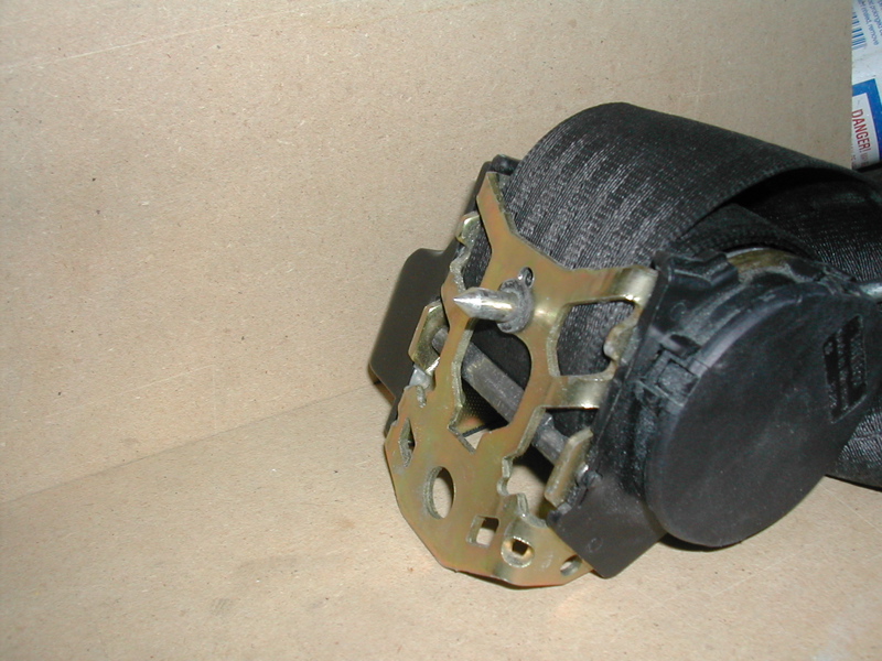

Here's a picture of the 944 belts with the big pin knocked off, the resulting hole tapped, and the original 914 pointy pin threaded in.
And here's how they look in the car. Very original.
