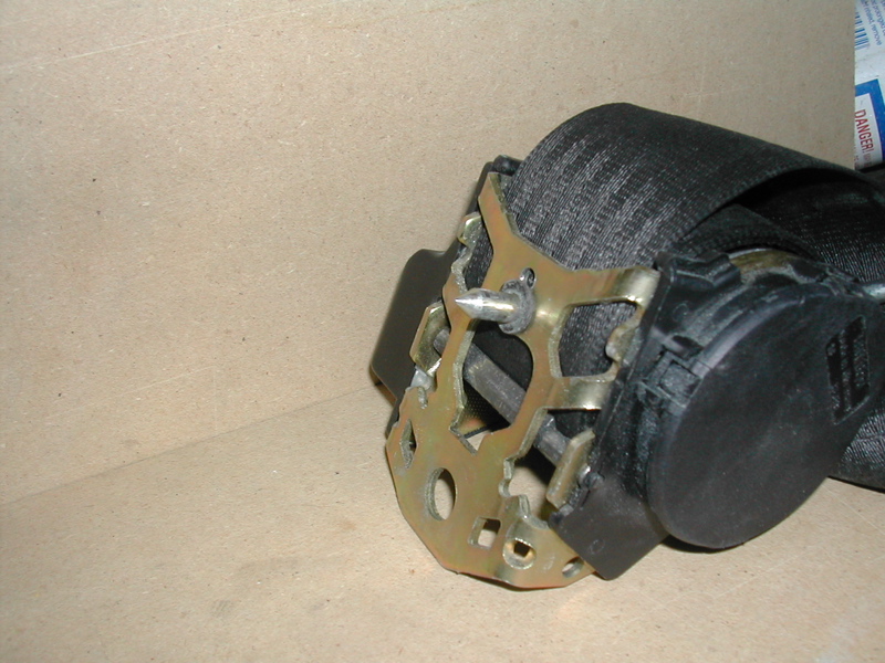

The 944 seat belt is identical to aq 914 one with one exception. There is a big-assed pin on the 944 seat belt that sticks out the back of it. That pin has to be removed to install it in a 914.

Here's a picture of the 944 belts with the big pin knocked off, the resulting hole tapped, and the original 914 pointy pin threaded in.

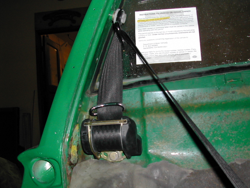

Click to view attachmentAnd here's how they look in the car. Very original.

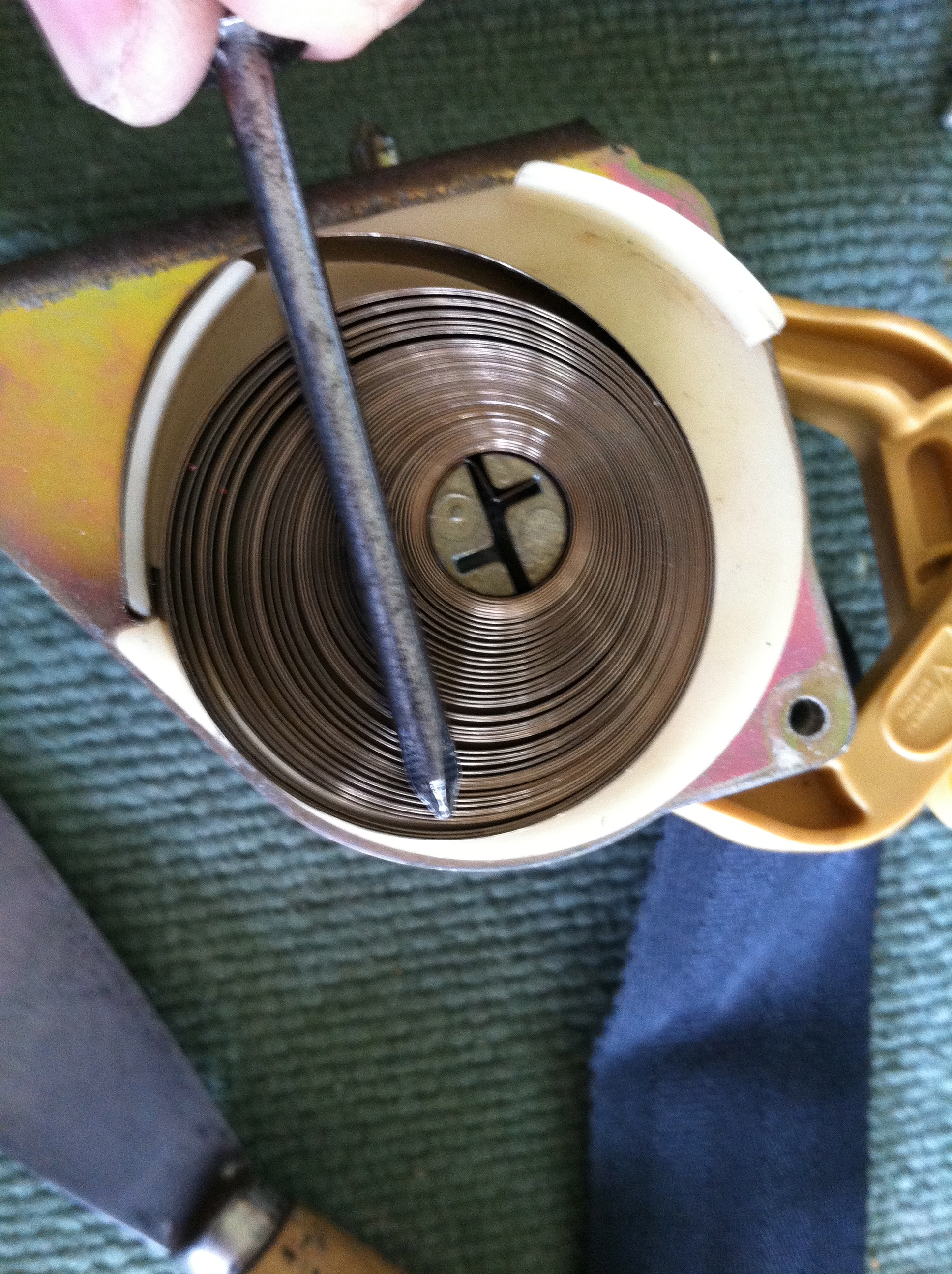

There I fixed it,
After taking one side apart to see why it did not retract, The spiral spring popped out and parts flew every where.
I then carefully took the other side apart (the narrow cap) and carefully slid a putty knife under the cover and over the spring to see how it's supposed to look like in there.
If the retraction is getting weak, you can take the spring outer end out of it's slot and wrap several more winds around and replace the spring in the slot.
If the spring has come out you have to re-wind it in the opposite direction it got itself into starting from the outside, be patient it ain't easy.. then with the belt fully extended, insert the spring inner end into the hub slot. make sure the little SS washer is in there first between the plastic cup and the spring. If more tension is needed, use the technique above.
Here's what it should look like in there with the belt about half way out.
