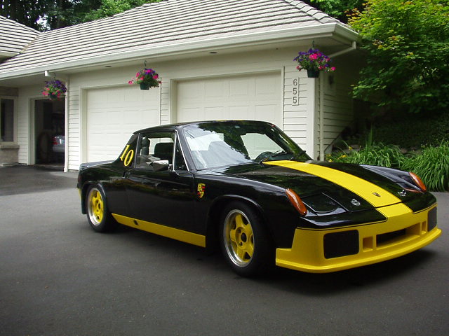

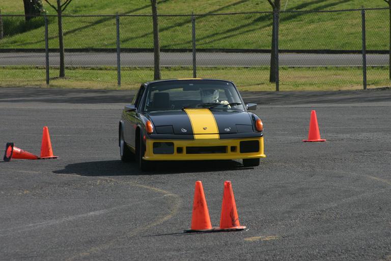

Here is my car.
17x7 Boxter S alloys, 24,5mm spacers , 20mm spacer on the left rear.
Mark
(IMG:http://inlinethumb55.webshots.com/1590/2242785290057582025S600x600Q85.jpg)
(IMG:http://inlinethumb25.webshots.com/4504/1253355808057582025S600x600Q85.jpg)
