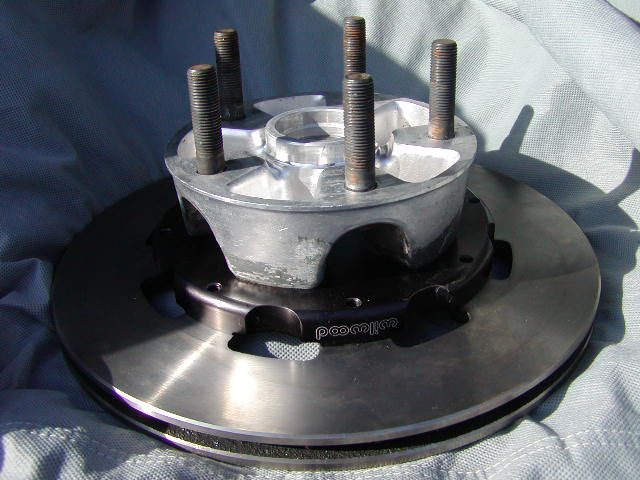

Below is a setup I put together using Wilwood parts. In order to fit the rotor (so it does not hit the a-arm, it needs to be flipped around (looks odd, but Wilwood does it on thier Mitsubishi EVO or Suby STi big brake kits)...TimT mentioned that you can also move the entire hub outboard by about .25" if you have a spacer behind the inboard wheel bearing.
These will be going up for sale pretty soon, probebly going to ask $200 for the hats, 2 new rotors and the bolts that attach the rotor to the hats. Replacment rotors are $37 each

Mike, nice setup. Do you have the part numbers for the Wilwood stuff?
rotor = 160-0277
hat = 171-7671 (undrilled, needs thru holes for the 5 bolts drilled as well as the opening up to fit the hub)

Mike whats the hat made of ...Alum? It looks fixed while some (Performance Frictions) claim to be floating?
it is fixed design.....Wilwood does have floating hats/rotors, but I really don't know much about them and couldn't justify the extra cost at the time.

Mueller what are the width and diameter of that rotor? Were you happy with the performance? What did you run on the rear of the car? Any balance issues? Did you use a adjustable pressure regulator? What size master cylinder? Thanks
12.19" x .810"
sold the car to which these were supposed to go onto....they are just collecting dust in my tool box (IMG:style_emoticons/default/sad.gif)
originally Mazda RX7 Turbo calipers had been planned to be used with them and I would have tackled the other issues as I got to them.
Only real differance between these rotors and pre-84 911 rotors (besides being lighter) is the OD is a little over an inch larger on these
