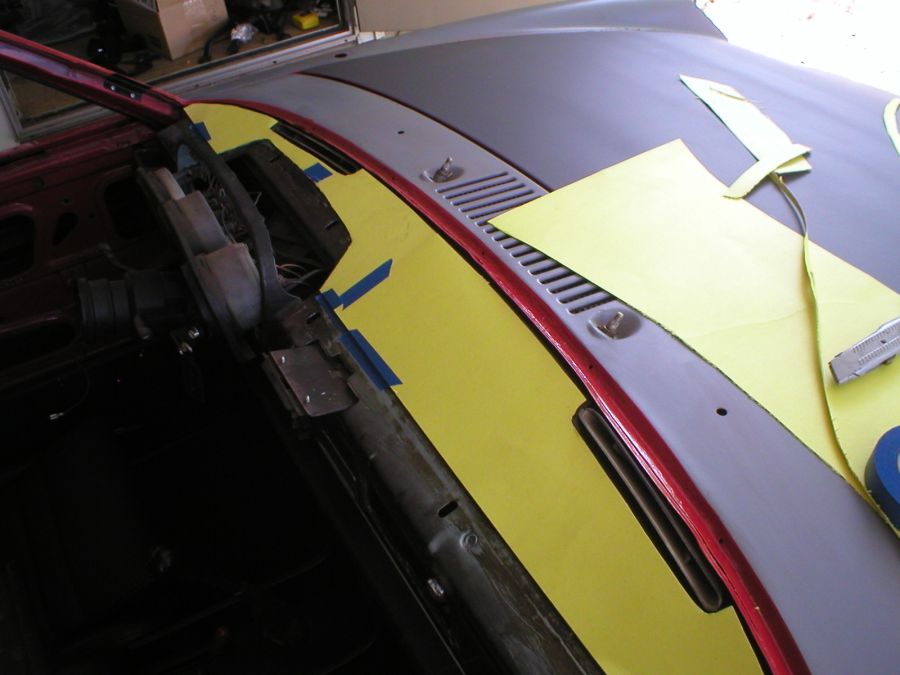

I received the closed-cell foam and installed the foam and vinyl today....
I first made a template..

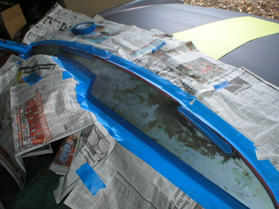

Next, I taped everything off to keep the glue from spreading...
Then I cut the foam to the exact size of the template and glued it in place...

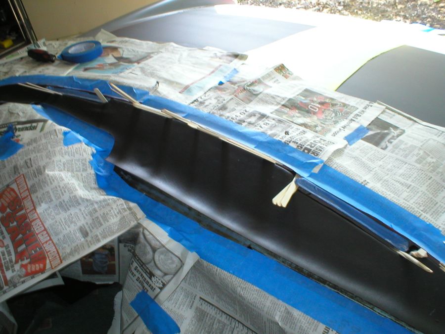

Then I glued the front section down. As suggested, I only glued the edges, nothing in the middle of the foam.... I used a screwdriver to push the leading edge of the vinyl down around the windshield... I used popsicle sticks to hold the edges down..
I let the front section dry a little, then I glued the back section. After making certain the vinyl was completely down and smooth, I placed the dash top on it to hold everything down....
I'll check tomorrow to make sure it stays in place...
