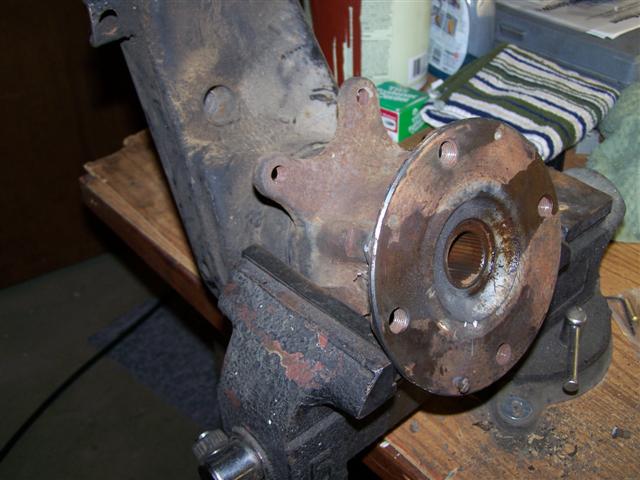

The PO of my car took it for a drive without tightening the lug bolts on the rear, he dorked up the bolts and the threads, I have a spare rear swingarm, but I cannot figure out how to get the hub off, I feel kind of stupid asking, but sometimes your brain locks...need beer! (IMG:style_emoticons/default/beer3.gif) In the pic it is the part that the bolts thread into. Would I be better off replacing the entire arm?

Flip it over....you'll see the wheel bearing and the other end of the hub.....use either a press or a suitable tool to drive both of them out.....

I went back out and looked at the damage that the PO had done. Two of the bolts were in normally, the other two were partialy in and cocked. About 1/2 of the threads on the bad holes were good, I tapped those holes from the back side and cleaned the other holes out. Once I was done all four went in by hand and torqued down just fine. Man I love it when a bad things ends up easy to repair, it does not happen often! (IMG:style_emoticons/default/beer.gif)
