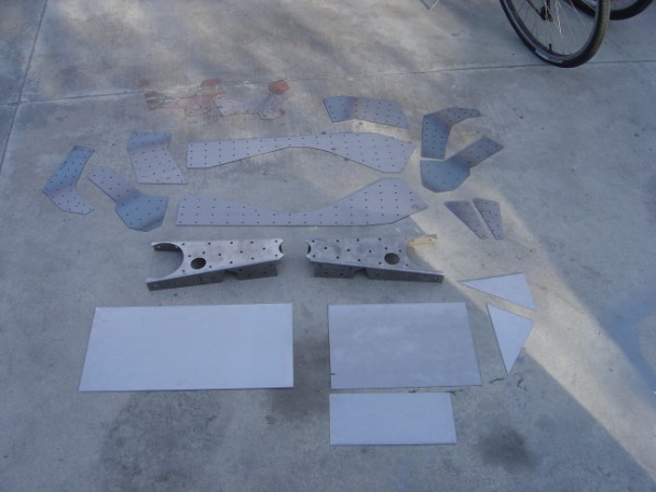

New parts came today from Chris at Tangerine Racing. I think I will weld these in today and get that step over with. Nice weather today so it should go smooth. It was raining yesterday which is really a hold up since my car is not yet in the garage. Maybe by the weekend I can get it inside.

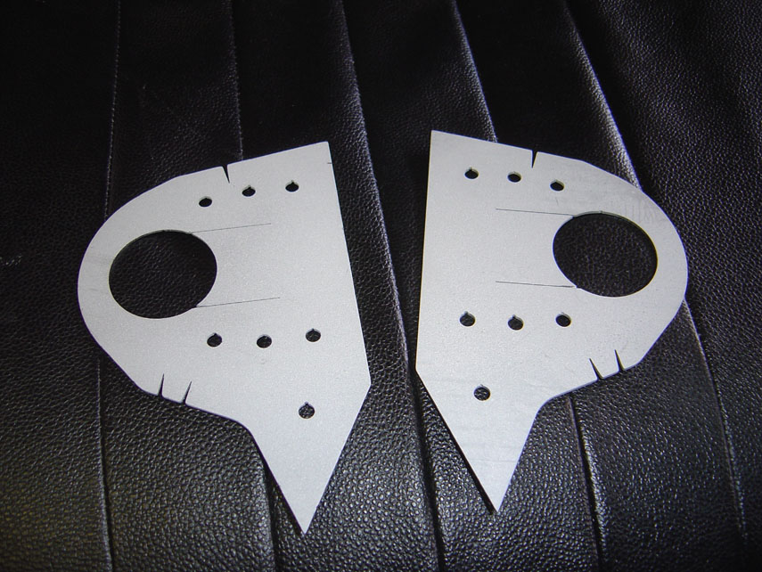

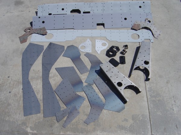

On the ajenda today is strip and prep the enderside of the car ready for welding in all the parts I got this week, with any luck I will have it all done by the end of the weekend. I know I will be working at the port on one day or evening but the rest of the time, I will be cleaning, grinding, welding, more grinding and painting. Here is the stuff for the outside of the car. The inside stuff should be here today from Engman.

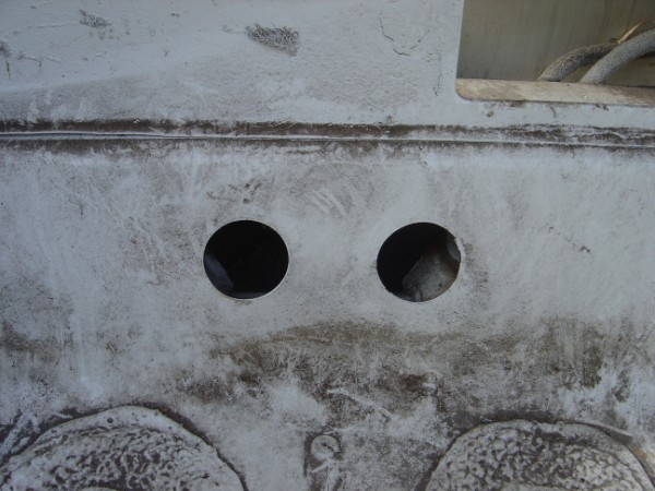

Just measured them, they are 2" across so I would guess make them 2.25" so the hoses fit since I am using marine exhaust hose, that should make a perfect fit.
(IMG:style_emoticons/default/sawzall-smiley.gif) (IMG:style_emoticons/default/welder.gif) (IMG:style_emoticons/default/smash.gif)

How big a flange ya need ??

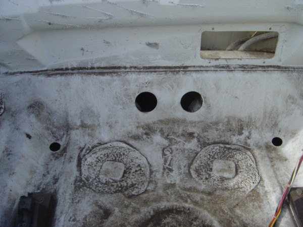

There are 2 holes and they are 2" each, I will open them up a little for the flanges and the hose I am using is a Marine Exhaust hose, after thinking about it, just make them both 2", I am sure the hose will fit through.
Here are aome pics of the holes

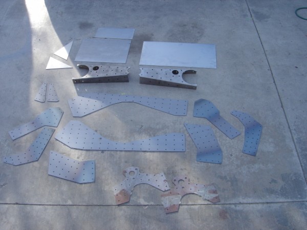

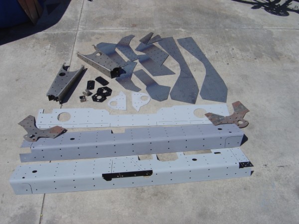

Here is an updated picture of the weld in kits going into this car. I wonder how much all of this weighs? It wont be the lightest car but it will be strong for sure and with the V8 it should still be fast enough.

Your electric bill is gonna be big!!!

You are missing the Brad Mauer outer stiffening kit... (IMG:style_emoticons/default/chairfall.gif)
It will add anther 50 or so pounds as well -
Good luck on your project, and do not get in a hurry welding in the Engman inner... you rush it, and you will mess up your door gaps big time !

This will be the fourth Engman inner kit I have done but thanks for the advice. (IMG:style_emoticons/default/smile.gif)

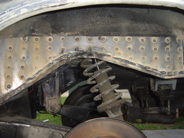

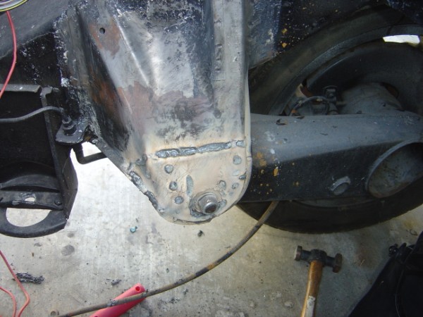

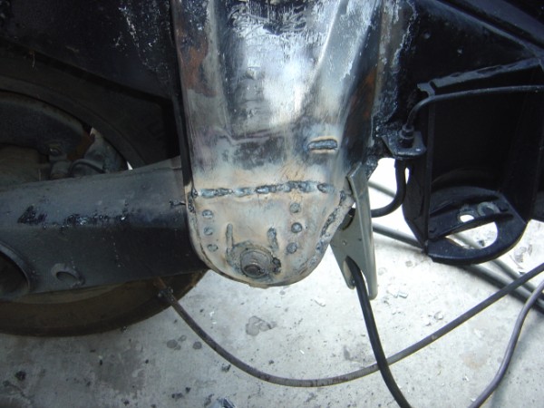

Welding in some of the parts today, I had forgotten how difficult it was to get the kit to lay flat. Here are some pics of what is being done so far. Almost done with the drivers side outer.
