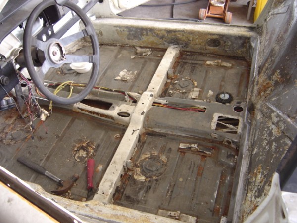

I am back working on the car again since it is in the garage and all. It's a nice day here in Sunny Southern California and I really should be over helping Joe pull his engine out so he can get it over to the paint shop and get it going. Our schedules did not coincide today so I came home and started in on mine. I got the passenger side of the outter stiffening kit welded in and will weld in the small pieces next and then grind it as smooth as possible with a 4" grinder. I pulled the entire rear suspension so I can weld in all the pieces correctly without trying to work around the control arms. They needed to come off anyway to clean them up and weld on the stiffening kit and then I may have them powder coated. Some of my welds dont look as good as some of my others, I think I need a new mask as I am having trouble seeing what I am doing as I go. I should have the entire outer long kit welded in today and then I can get started on the inner long kit from Engman. I also have the front sway bar reinforcement kit to weld in on the front along with the actual sway bar mounts to weld in so I may pull the front suspension today as well and put the car up on 4 jackstands. Yes, I am taking pictures as I go to document progress and what I have done to the car. I will post some up now and then more later today.

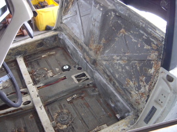

Why cant I get a straight car for once??? I was working on the car today and started stripping the paint from the rear quarter that had the dent in it on the drivers side. I knew that both rear fenders had been grafted on from other cars and the dent should have been easy to repair. Not sure what I will do at this point but I will continue to strip all the bondo and crap and I may wind up just replacing the whole quarter panel with one I have on the side of the house. Notice the door gap and the line where the metal ends. I would guess the bondo amounts to about 8 to 10 pounds on this side alone. (IMG:style_emoticons/default/headbang.gif)
The last shot is looking up inside the fender

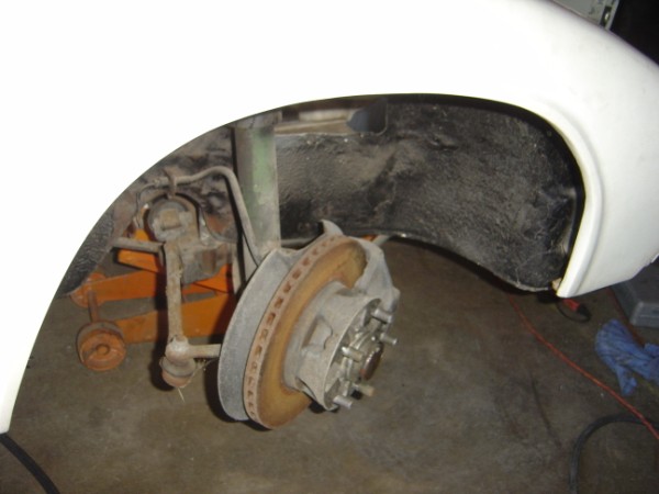

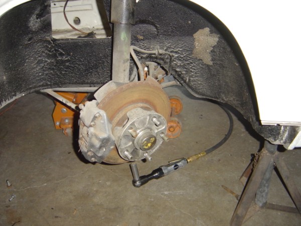

A little progress update and question. Can anyone identify the front struts on this car? Isnt green struts Bilstien? Or are the Boge? It is a Carrera front suspension and I will be griding off the front sway bar rings to replace with the U tabs to run a through the body sway bar. I am also going to replace the tie rods with a set of the Turbo tie rods so if anyone has any laying around, let me know. Here are some pictures of the progress I am making on this car so far.

QUOTE(skline @ Apr 23 2007, 01:36 PM) *
I don't remember the color codes but mine had "BOGE" stamped into the strut.
Aaron Cox
post Apr 23 2007, 04:15 PM
Post #89
Professional Lawn Dart
Posts: 24,542
Joined: 1-February 03
From: Corona, CA
Member No.: 219
green housings are bilstein....
if its black with a green dustcap up top... its a bogelstein (bilstein was the only company to make replacement upper caps LOL)
black housings say BOGE on them as allan mentioned

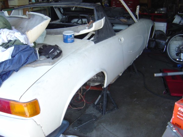

Well, it's Saturday of Memorial weekend and I am stuck in town hoping for a job at the port this weekend so I figure I would do some stuff to my car since there is so much to do. Today, I got up and decided to cut off the fender I just worked over trying to make it right. Since the door gap was not good and never would be right so I fingured I would fix it and make it right (IMG:style_emoticons/default/smile.gif) Thats what I try to do. Well, as you can see, I have cut part of the fender off to replace with a new one I have here already. The door gap was really messed up so I knew I would have to start there. I cut back to the middle of the fender right in front of the fender well opening. I kind of liked the way the PO had flared it to fit 225's on 7 inch wheels and still look stock at first glance. Well, the damage to the door jamb was worse than I had expected after I cut it off. (IMG:style_emoticons/default/sad.gif) I can fix it and I will have to now in any case. After talking to Joe Buckle, I am thinking I may buy his rear flares he has up in his garage that he has changed his mind about using and he in now going with a full Sheridan kit. I want to get those from him and see how they look on the car and what I will need to weld back in to use them. Here are some pics of what I have done so far this morning.
