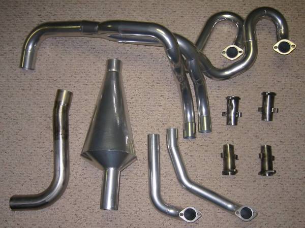

I still say, and always will that the TIVs biggest enemy is not in the delivery of air/fuel....but rather the exhausting of the mixture! Not getting the previous mixture out before attempting to get a new mixture in, is the fastst way in the world to kill power and make hot cylinder heads.
Save money on carbs, and buy a 1-3/4" Tangerine Racing Header.....Its the only thing I have found that gets rid of the gasses enough for any engine above a 2316!
Dyno and track proven! Chris made it to the runoffs- and with less engine than many others!
I have sen 10K buck engines with a 200 buck exhaust..... I have seen 2,000 dollar engines with a 2,000 buck exhaust........ I have seen the 2,000 buck engines, spank the pants off of the 10K buck engine!
The Tangerine header is the qual to a set of 48 IDAs, just on the other side of the camshaft!
What goes in, must come back out.
Buy One.

IMHO, you would get better performance using 44IDF's with big chokes and this exhaust system, than you could with 48IDA's and a 1 5/8" 4into1 header.
Total - $1995 H/T Coated, includes mounting hardware and shipping.

Exactly.... I'll second, third and fourth what Chris said.
Get that exhaust out!
