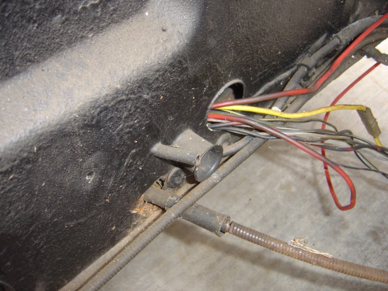

skline
post Mar 16 2007, 11:46 AM
Born to Drive
Posts: 7,910
Joined: 26-December 02
From: Costa Mesa, CA
Member No.: 17
They say "a picture is worth a thousand words" so here ya go.
John
post Mar 16 2007, 11:55 AM
member? what's a member?
Posts: 3,393
Joined: 30-January 04
From: Evansville, IN (SIRPCA)
Member No.: 1,615
On a repair like that one, I like using a 1/2" Fender washer with one side cut off to make a sort of D shape.
The flat would mount in the down position (where it would meet the floor seam)
You may have to grind some other spots to clear everything, but it works well. I full weld the washer to the car and then tack the tube to the washer until it is a continuous weld. Inserting something into the end of the clutch tube helps prevent the weld from penetrating the tube and causing problems.
In my BLOG, I show a plate with a 1/2"diameter hole drilled in it welded onto mine.
Good luck.

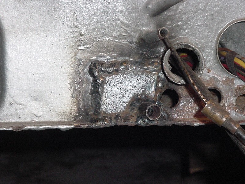

John
post Mar 16 2007, 03:52 PM
Posts: 3,393
Member No.: 1,615
In this picture, I used a larger piece of sheet metal (12 ga I think) as the area had been torn much like yours. I wanted a larger area to support the pressure on the clutch cable tube. The welds aren't much to look at, but they are strong.
skline
post Mar 16 2007, 05:51 PM
Born to Drive
Posts: 7,910
Member No.: 17
Thanks John, that is perfect, I am going to go with a hydraulic setup but I still want it to be repaired so I will do it just like you did with the heavy steel.
