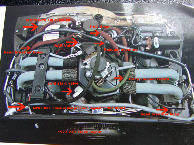

The grey paint covers the intake, dunno what color it is. Look at the factory pic

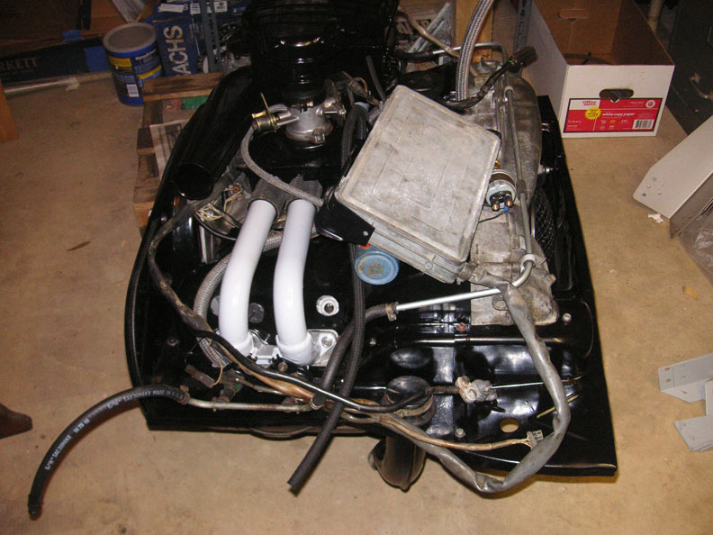

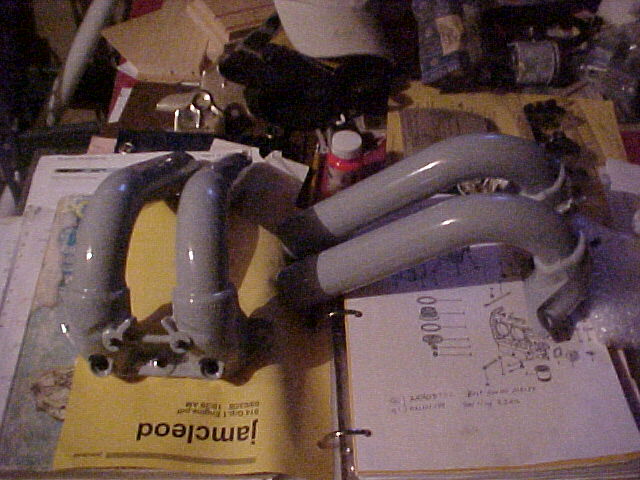

yarin
post Mar 18 2007, 07:49 PM
'14-X'in FOOL
Posts: 988
Joined: 13-May 03
From: Guttenberg, NJ
Member No.: 693
I also sand blasted then powder coated mine:
before
(IMG:http://farm1.static.flickr.com/77/193061253_cd9c866f97.jpg)
AFter:
(IMG:http://farm1.static.flickr.com/48/139977706_7c13bba7dc.jpg)
I believe they are interchangable.
