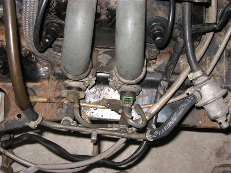

ok I am installing a replacement engine and going over the engine before I plop her in the teener and low an behold the fuel line to the cold start valve has been cut and I can't find an open spot for the line to go to ?! please help ...2.0L d jet

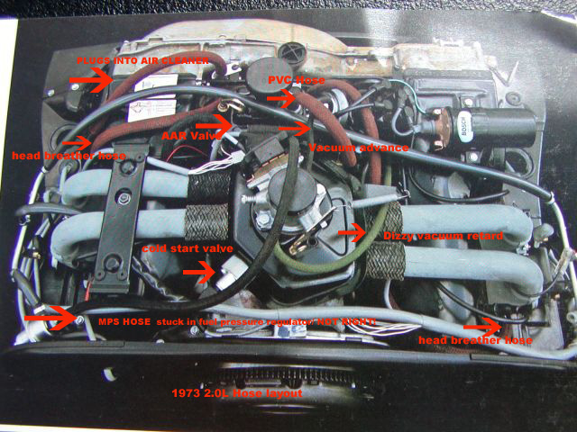

look at this pic

QUOTE(Bleyseng @ Mar 21 2007, 09:10 AM) *
look at this pic
I can't tell where it leadfs to.. but it looks like there is a line going to the top of the fuel rail... it thought that was for pressure testing ?!
Bleyseng
post Mar 21 2007, 11:31 AM
Aircooled Baby!
Posts: 13,036
Joined: 27-December 02
Member No.: 24
The side with the FP has the rail with three outlets, battery side gets the one with the plug.
The center outlet goes to the cold start valve.
