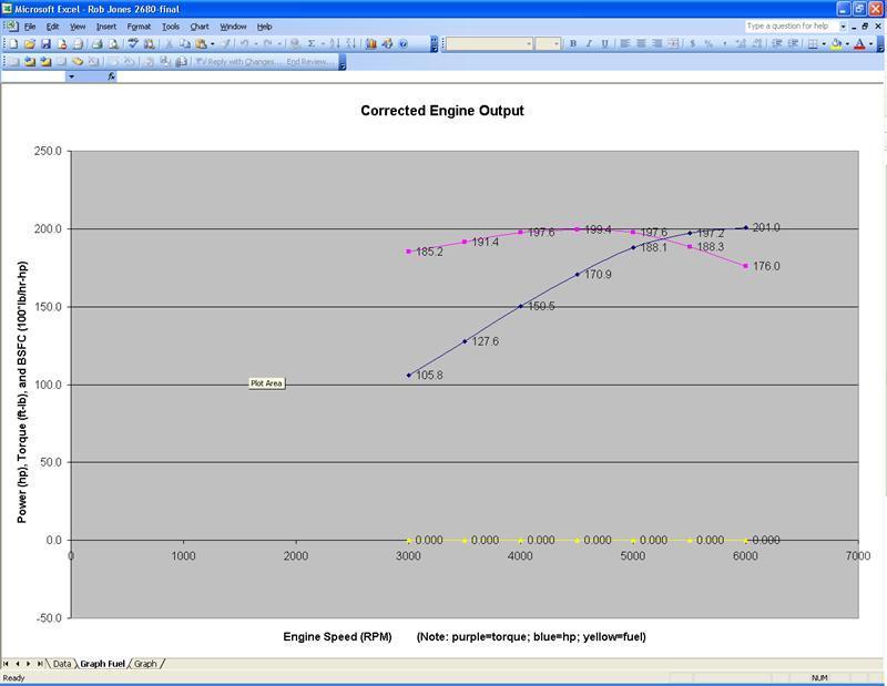

Look at that fat, flat torque curve!!!
Look at this! This engine uses one of my new 9700 series cams (non roller) coupled with LE 200-102 heads and 8.5:1 CR!!!!!
It uses RAT SDS EFI/ direct ignition with 45mm T/B and a 1-3/4" Tangerine header.
The engine is for a 2007 Intermeccanica Speedster and belongs to a European customer... I think he'll be really pleased with the torque curve and overall output this MassIVe engine provides. I am building one of these in 6 weeks for a 914 application, so I thought I'd share some numbers..
Lets don't start a "six Vs four" debate with this one and before you ask me how much it cost I'll go ahead and say "enough" as sharing the cost of this custom engine publicly would not be fair to my client.
We have been raising the bar higher and higher almost weekly for the last six months, 7 months ago this engine made 15% less power with another full digit of CR!

Im not gonna ask how much, but how big?
Is that a 2270?

My guess is 2680.

What's the displacement on that engine Jake?

Its actually a 2615, the file name was 2680 as I was comparing it to a 2680 in an overlay prior to this screen shot :-)
Not bad for an engine that will run on 87 octane and idles at 700 RPM...
I expect to break 200HP at less than 9:1 with a 2270 next week for the first time ever on pump gas...
BUT the build up of the engine for the Television show might hinder that a couple of weeks...

So, what happens from idle to 3k rpm?

think of it as a 911 S motor... until it gets on the cam... its irrelevant...

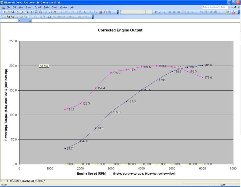

95% of my engines demand premium fuel.. This engine was different as it will be used in some remote parts of Europe on long trips and higher octane fuel may not be available so I engineered some flexability in it's creation- thats the benefit of a custom engine program.
That could not be further from the truth! These big engines make huge torque at very low revs- I just didn't inclue those values in this screen shot I posted- I will attach another that illustrates them below.
The HUGE advantage that a big engine like this has for a street car is the big flat torque curve at lower revs which really promotes drivability and keeps things very fun, if you are like me moking the tires on demand is always fun in 3rd gear. You can look at the peak torque point and see how much lower it is than a comparable output six..
This engine is built for long distance, intercontinental European cruising with tall gears in an Intermeccanica Roadster more than anything- it gives the term "dual purpose" a new definition. This combination LOVES the stock gearing of a 914 as well.
Thats right this engine pulled as low as 1,500 RPM at wide open throttle and still made power.. Thats the glory of I?R Engine Management and a correctly configured engine that it's feeding..... I actually pulled the engine to 1,000 RPM but didn't save that data ;-)
This baby is on the cam at damn near idle! It really starts to wake up through the dyno controls around 2,300 RPM and then comes on harder around 3,400 when the heads really wake up and port velocity increases..
This is a daily driver- remember that.....
