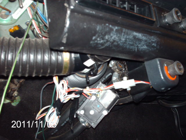

budman5201   Has anyone ever thought of using a Water to Air in...   Nov 17 2007, 12:21 AM
partwerks   Seems like in the past I had seen a 914 member tha...   Nov 5 2011, 08:03 PM
pdlightning   Seems like in the past I had seen a 914 member th...   Nov 5 2011, 10:03 PM
partwerks   I'll have to crawl around under there and take...   Nov 5 2011, 10:52 PM

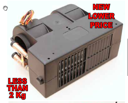

3d914   I was planning to put one of these into one of t...   Nov 6 2011, 07:19 PM
ruby914   I was planning to put one of these into one of ...   Nov 20 2011, 02:00 PM
speed metal army   Couldnt a guy make some Heat exchangers for the ...   Nov 6 2011, 10:56 PM
3d914   ruby, Its from this catalog. You want page 191. I...   Nov 29 2011, 09:37 PM
ThinAir   Its from this catalog. You want page 191. I belie...   Nov 29 2011, 11:49 PM

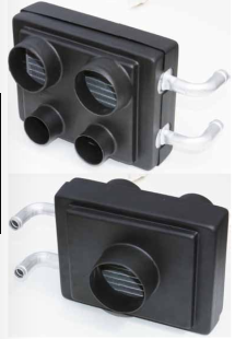

3d914   Ernie, that's basically what I had in mind, ex...   Dec 3 2011, 06:34 PM
partwerks   The Renegade Hybrids under dash unit has the capab...   Dec 3 2011, 06:56 PM

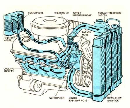

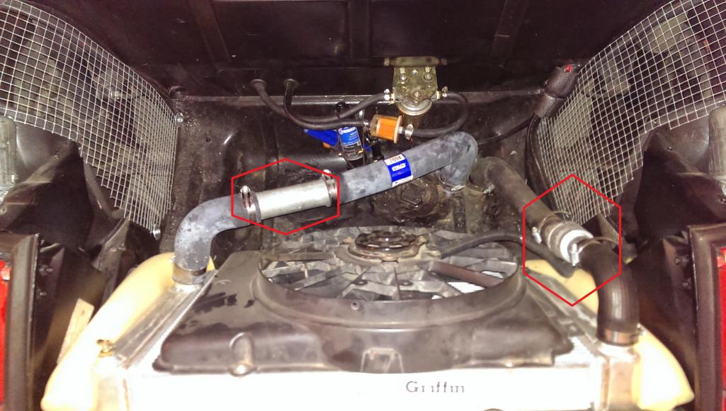

BRAVE_HELIOS   I have a 71 Chalon with a SBC. When building the c...   Nov 7 2014, 11:28 PM
BRAVE_HELIOS   I have a 71 Chalon with a SBC. When building the ...   Nov 8 2014, 03:37 PM
Mike Bellis   Sorry, I didn't see the question. Yes, in theo...   Nov 8 2014, 04:45 PM
BRAVE_HELIOS   Sorry, I didn't see the question. Yes, in the...   Nov 10 2014, 10:27 PM
BRAVE_HELIOS   Sorry, I didn't see the question. Yes, in the...   Nov 17 2014, 11:30 PM
Mike Bellis   Pressure differential. it will flow. This is where...   Nov 17 2014, 11:53 PM
