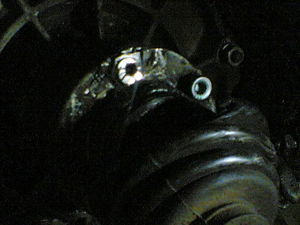

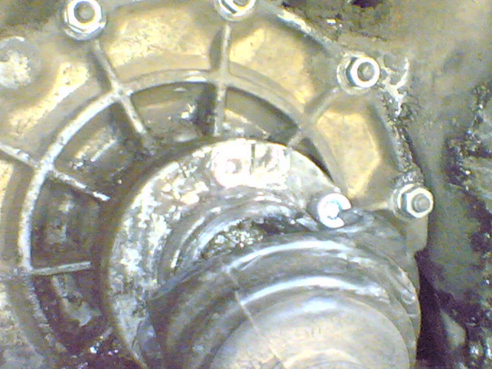

holy begeezus, seems things dont want to work out for me.
short vers.
cv bolt
not a torx driver
stripped... (IMG:style_emoticons/default/confused24.gif)
SEARS!
bolt remover
head snapped off.
two weeks later
still stuck.
tried various things,
pb blaster, reverse bits, tap die set. drill
nothing seems to work.

I would grind the head off. Remove the other bolts and the CV joint. The bolt should then screw out. Maybe loctite was used. Heat it and use vise grips if it is stuck.

Ya, heat it just a little. Someone may have used locktite. Also you may be able to weld a nut over the end of the fudged head and back it out that way. (don't ask me how I know... (IMG:style_emoticons/default/mad.gif) )

And it's definitely not a Torx head. You want an "M8 triple square", or "the Bug CV joint socket".

Dang... at this point I would have welded a 3/8 extension on it and busted that nut..

Like Mark suggested, I would grind it off to get the CV joint off. You could then use a locking type pliers to remove the bolt. if it is still stuck, you can get a real cheap output flange for the trans.
