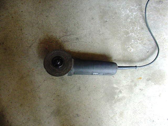

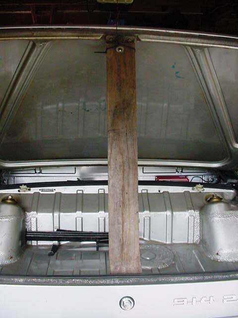

tools required:
grinder
a couple of old bath towls
10mm deep well 1/4" drive socket, ratchet and long exstension (disregard the ones pictured)
2 zip ties
a 35"stick

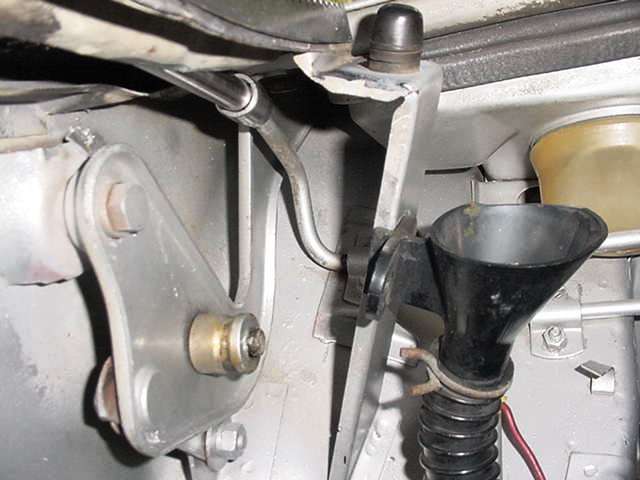

1. slip socket w/ext on the pass bar end @ the roller. you may have to persuade it a bit.
2. press the exstension down and lever the end sideways off the roller.

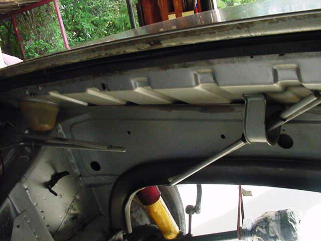

3. prop trunk open, and secure it at the top. see picture.

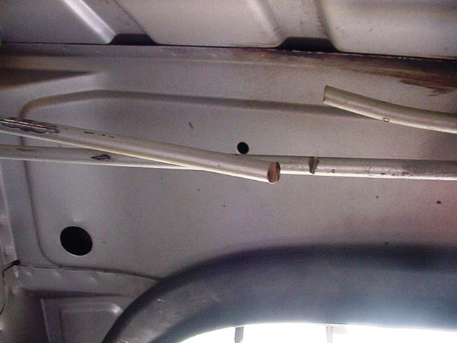

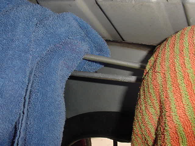

4. climb into the eng compartment, fold the towels so they're thick. pull the springs toward you a bit and stuff the towels on both sides of the point you are going to cut. if the towel goes in easy, refold and repack. it should be a jammed in fit.
5. make 1 cut at a time! you may want to repack the towels after the first cut. cut other spring.

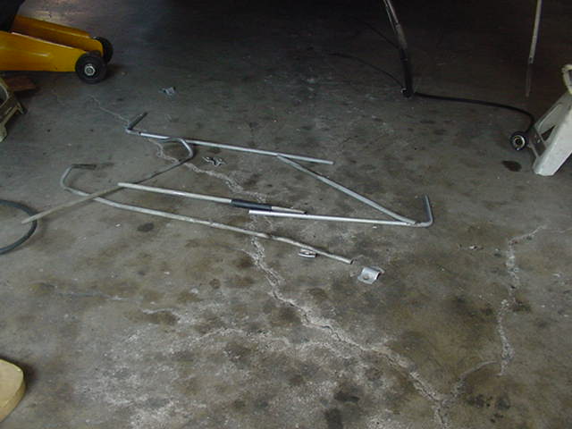

6. take your 10mm setup and remove the 4 clips the that secured the springs to the body. throw scrap on garage floor for pictures. DONE.
