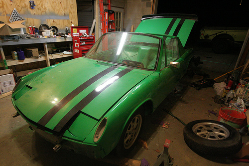

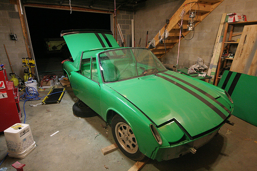

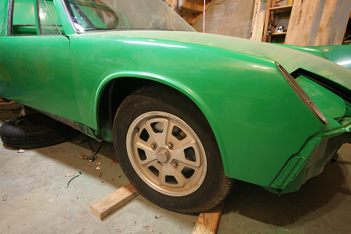

Yeah, we got a ton done yesterday. I have pics uploading into Flickr to host up in a moment.
Inlaws came over before Mike left. A soon as Mike went to go get his woman, I turned into a plumber, and spent the rest of the night (no really, till around 10pm - which is late for e these days) sweating in some new valves and copper pipe in the basement. The joys of home ownership. :-) But. now my valves don't leak, and I learned a new skill.
I did not post before now, as I had to repay Erin for watching the kid all day yesterday by watching him all day today. Payoff was that Erins mom came over and watched the kiddo, and I got to take my woman on an honest-to-god date. Good old dinner and a movie. Iron Man was awesome.
Are my pics uploaded yet? I am sure you are tired of hearing about my life as a family man...
Nope, 29% complete.
Anyhow.
MY CAR WAS 100% OFF JACKSTANDS FOR THE FIRST TIME IN ALMOST 3 YEARS! Emphasis on "was." The ass end is back in the air, after I knocked the axle nuts off. Air torque wrench took them off in seconds. Mike did not think it would work.
Showed Him. (IMG:style_emoticons/default/bootyshake.gif)
Took the rear disks off to get turned, and I am going to repack the bearings while I am in there. Disks go to the machine shop to get turned tomorrow. Then I put them back on, along with my new Eric Shea rear brakes.
Mike found some rust that I missed int he engine bay, so I ground it off and hit it with Eastwoods Rust Converter. Rattle can primed it this AM. Not pretty, but better then rusty.
I was not able to source the seals locally that I needed for the engine, so that was a non-starter. (hahaha - I kill me)
Mike got the engine bay seals in, except where I needed to re-weld the seal track in and fix the rust. Stupid A/C install. I wish I could beat the guy that installed it back int he way back.
Pics are loaded.
(IMG:http://www.914world.com/bbs2/uploads_offsite/farm4.static.flickr.com-179-1274378920.1.jpg)
(IMG:http://www.914world.com/bbs2/uploads_offsite/farm3.static.flickr.com-179-1274378921.2.jpg)
(IMG:http://www.914world.com/bbs2/uploads_offsite/farm3.static.flickr.com-179-1274378921.3.jpg)
There, pics of where I left it last night. Holy cow, I forgot how low this bitch was.
The wheels will be black. The fronts still need brakes on, so it will have to go back up. But not as high, and not as long. Brakes are rebuilt, and sitting in the trunk, just need to plug them in. AND I GOT TO SEE THE CAR ROLL!
I told Mike to scram after he *tried* (and failed) to beat up my truck. It was tougher then him. The roll cage he wanted to cut off laughed at his puny efforts. Ate a new saw blade, and I can barely see the scratch that Mike put in it. No pic, it was dark. I'll cut it off with an air cutter.
For the Porsche, at least, I see the light at the end of the tunnel. Especially if people come over to keep me focused on work. I'll give you food and beer. I'm off classes till the end of June.
Yeah, thats a hint. Blatant, huh.
Help me get this thing drivable by ECC in September!
