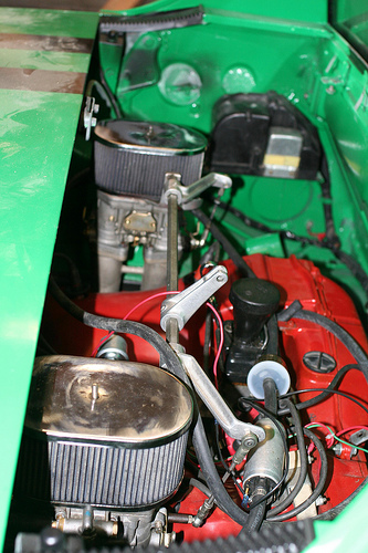

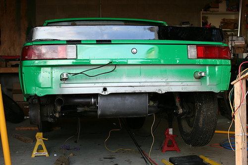

A BIG moment yesterday...
(IMG:http://www.914world.com/bbs2/uploads_offsite/farm4.static.flickr.com-179-1274379064.1.jpg)
(IMG:http://www.914world.com/bbs2/uploads_offsite/farm4.static.flickr.com-179-1274379064.2.jpg)
My engine still needs some tuning.
After nearly three years of seperation...
My engine is IN THE FREAK'N CAR!
Zach

Special thanks to ScottyB and DrEvil. We got a ton of stuff done this weekend on my car. While I was working on the bumpers Mike and Scotty were just "Lets put the engine in the car." "Okay" And it was done.
Then we had a party. :-)
Zach
