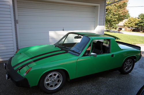

Some pictures from today after a bath.

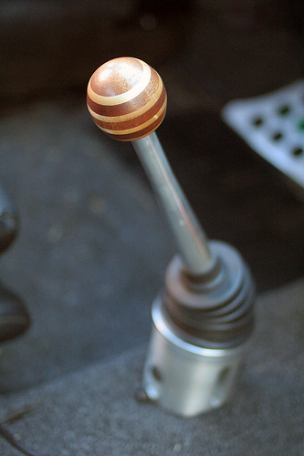

(IMG:http://www.914world.com/bbs2/uploads_offsite/farm3.static.flickr.com-179-1274379342.1.jpg)
closeup of the finished shifter knob that I made a while back. It is starting to get further polished by the oils in my hands when I use it.

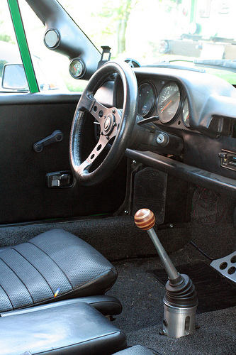

(IMG:http://www.914world.com/bbs2/uploads_offsite/farm3.static.flickr.com-179-1274379342.2.jpg)
My interior is still a work in progress. Its passable right now, but I look forward to getting my seats recovered.
(IMG:http://www.914world.com/bbs2/uploads_offsite/farm4.static.flickr.com-179-1274379342.3.jpg)
My ride, all clean from a bath. It ain't perfect, but I like it.

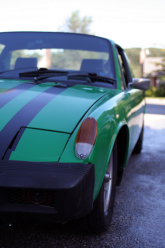

(IMG:http://www.914world.com/bbs2/uploads_offsite/farm4.static.flickr.com-179-1274379342.5.jpg)

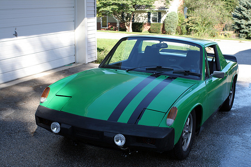

If I fix that headlight, I can't get it aligned right. I guess I'll just live with it.
(IMG:http://www.914world.com/bbs2/uploads_offsite/farm4.static.flickr.com-179-1274379343.6.jpg)
My car. I really like the look of the front bumper with the ralley style driving lights. Now I need to wire them to turn on with the parking lights.

what is the deal with the driver side eyelid, looks like it needs a little adjustment (IMG:style_emoticons/default/idea.gif)
