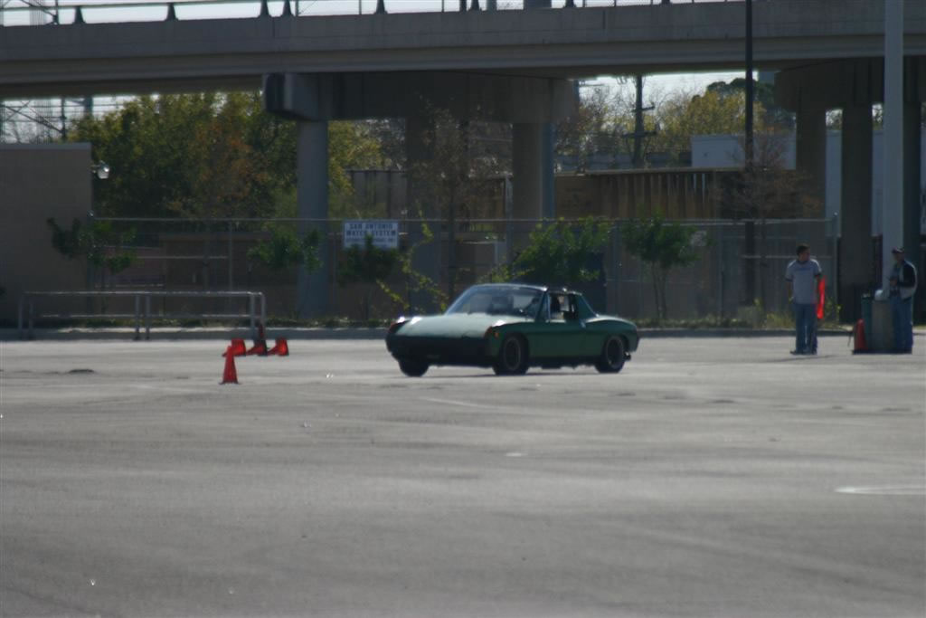

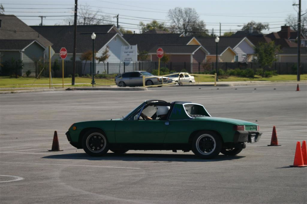

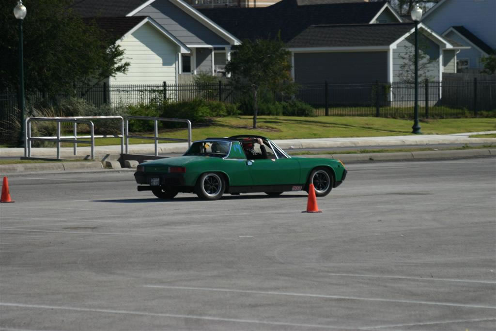

Here are a few shots of the car in action...somebody at the event took several pics of my car!

post Dec 8 2003, 09:32 PM
MUSR 8 - 5lug conversion done wed - drive 500miles thrus
Posts: 739
Joined: 31-December 02
From: Austin, TX
Member No.: 63
lifting the inside front?
cha914
post Dec 8 2003, 09:33 PM
Posts: 739
From: Austin, TX
Member No.: 63
turn damit...turn ...
