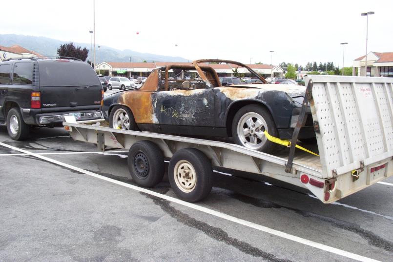

Jamies new car.

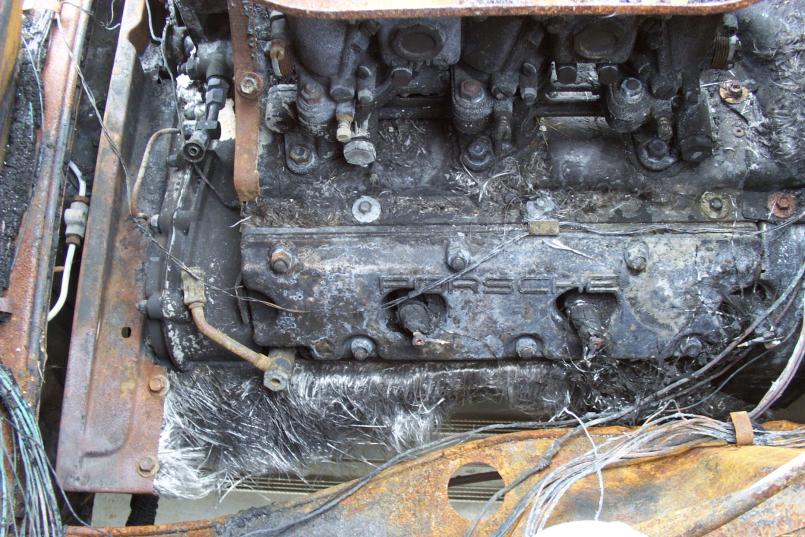

More...

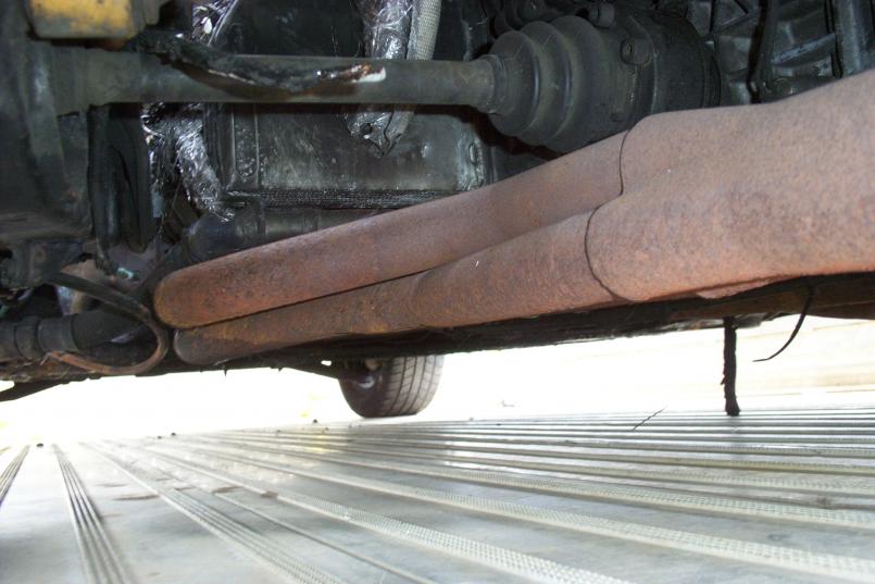

bottom side..

Heck, it even looks like the oil lines may still be good.
