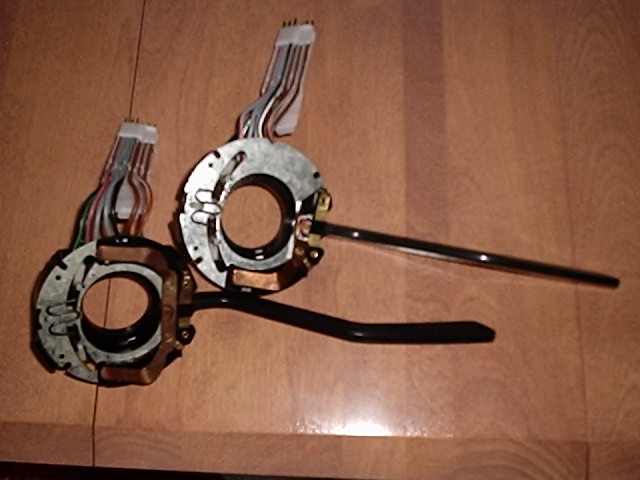

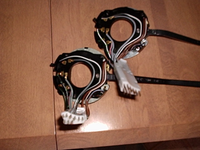

I have added some pictures for inquiring minds that need to know. You can go to www2.cip1.com and purchase one for the correct year model you have. The VW Beetle year model corresponds to the 914 year model.

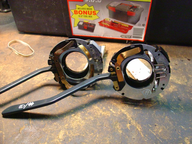

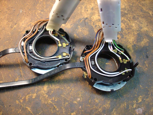

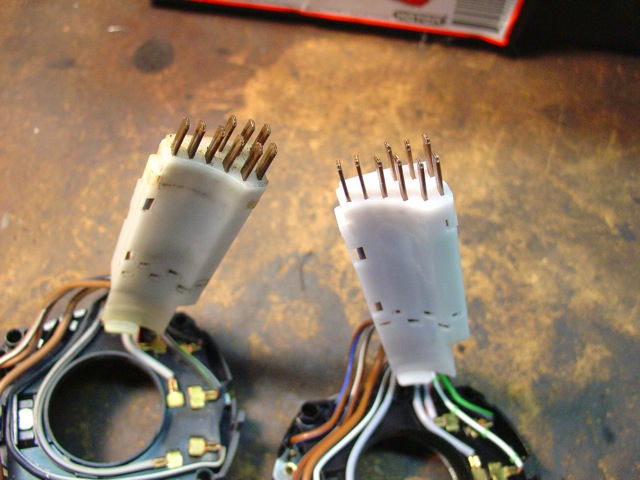

I can confirm that a 1972 VW Beetle turn signal switch is a direct replacement for the one I took out of my 1972 914.
This is the part I bought: http://www.jbugs.com/product/111953513F.ht...gory_Code=12396
New switch is on the right in these photos.

can you also get the equivalent wiper switch? that way both are new..

Lookin' good. One more pesky problem off the list.
