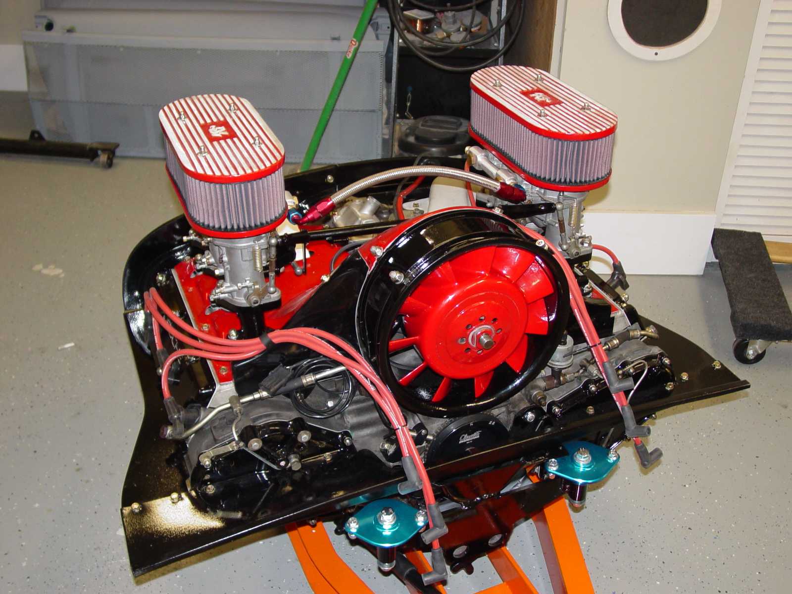

here is an engine pic from before the install...she looks good! If not a little bright!

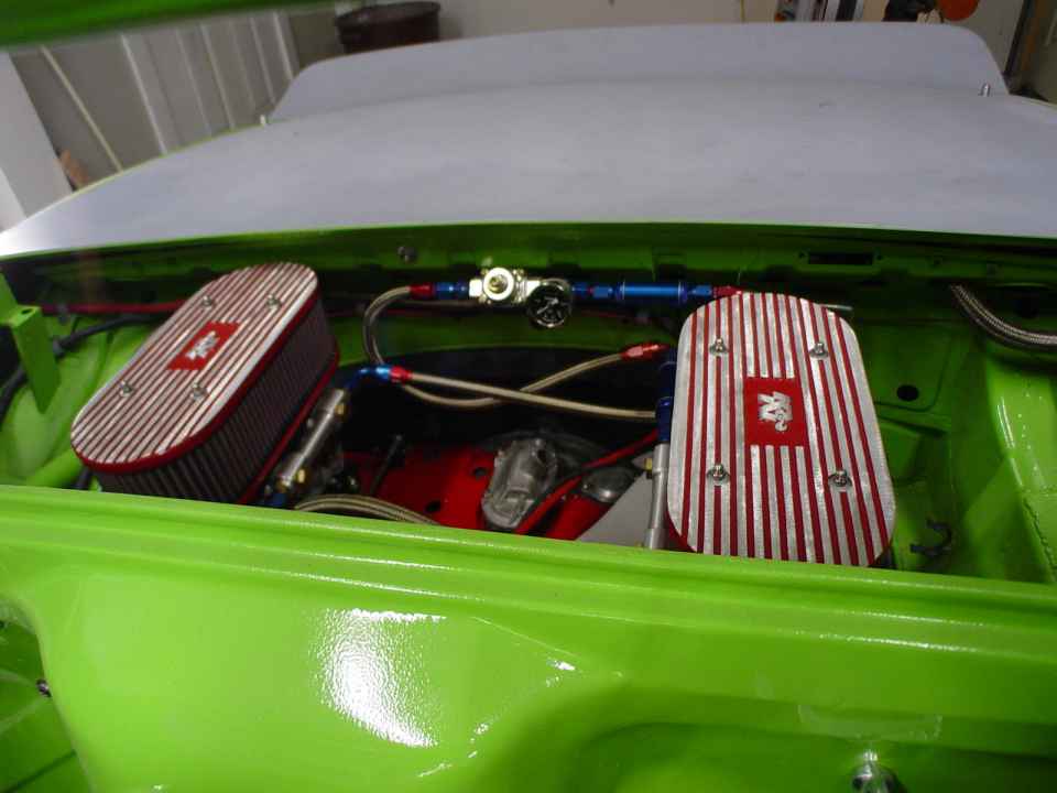

motor in place...just to get the pics in the correct thread...

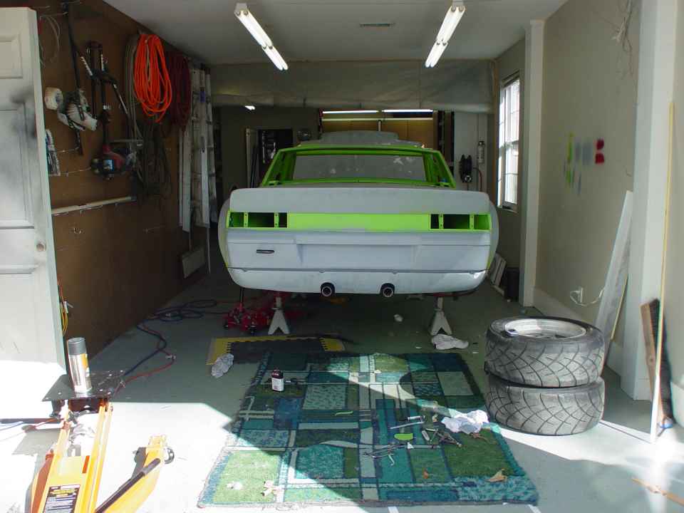

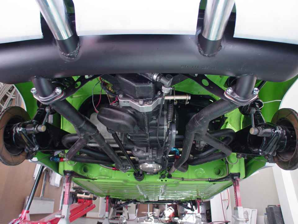

OK boring progress....brakes bled...1 leak @ the Jwest prop valve...lotta fluid in these bigger brakes with the 23mm MC, running cables oil lines shift rod...dull stuff but after a lil cutting and some muffler painting and polishing the tip...PERV! I have some goo shots...I mean good shots up er ass!

Looks good, you got a lot done...

QUOTE(crash914 @ Mar 1 2008, 06:39 PM) *
why does this picture remind me of christmas? (IMG:style_emoticons/default/idea.gif) (IMG:style_emoticons/default/confused24.gif) (IMG:style_emoticons/default/santa_smiley.gif)
(IMG:style_emoticons/default/biggrin.gif) Andy
PS: looking good!
