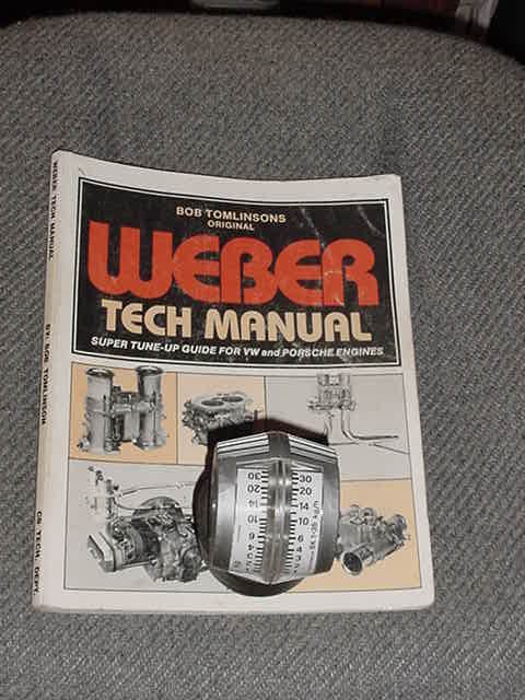

do you get a snap or pop when you open the butterflies? what effect do the air fuel mixtures screws have on your idle? you REALLY need to get bob tomlinsons "Weber Tech Manual" available from cb performance(follow the initial setup proceedure!) and the tool on top of the book in the picture. get the book and save yourself weeks of frustration. if you haven't done so post your engine parameters, type and size of your carbs, and your current jetting combination. contrary to opinion, not all dual carb setups snap and pop.
