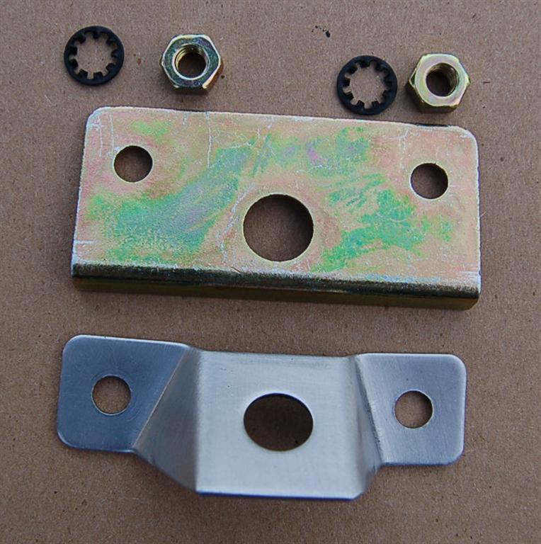

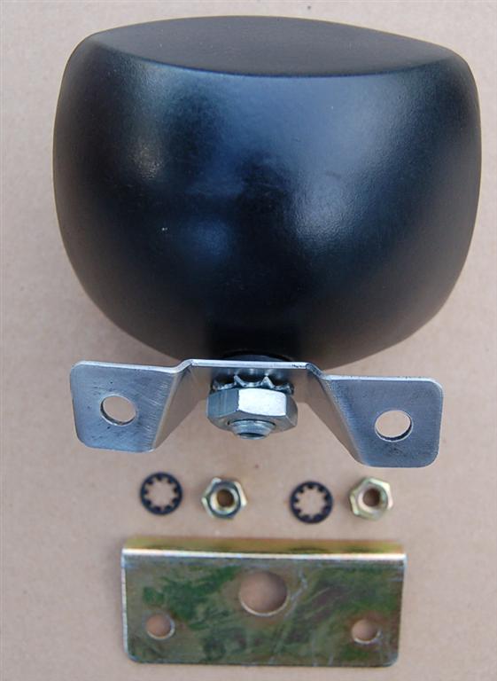

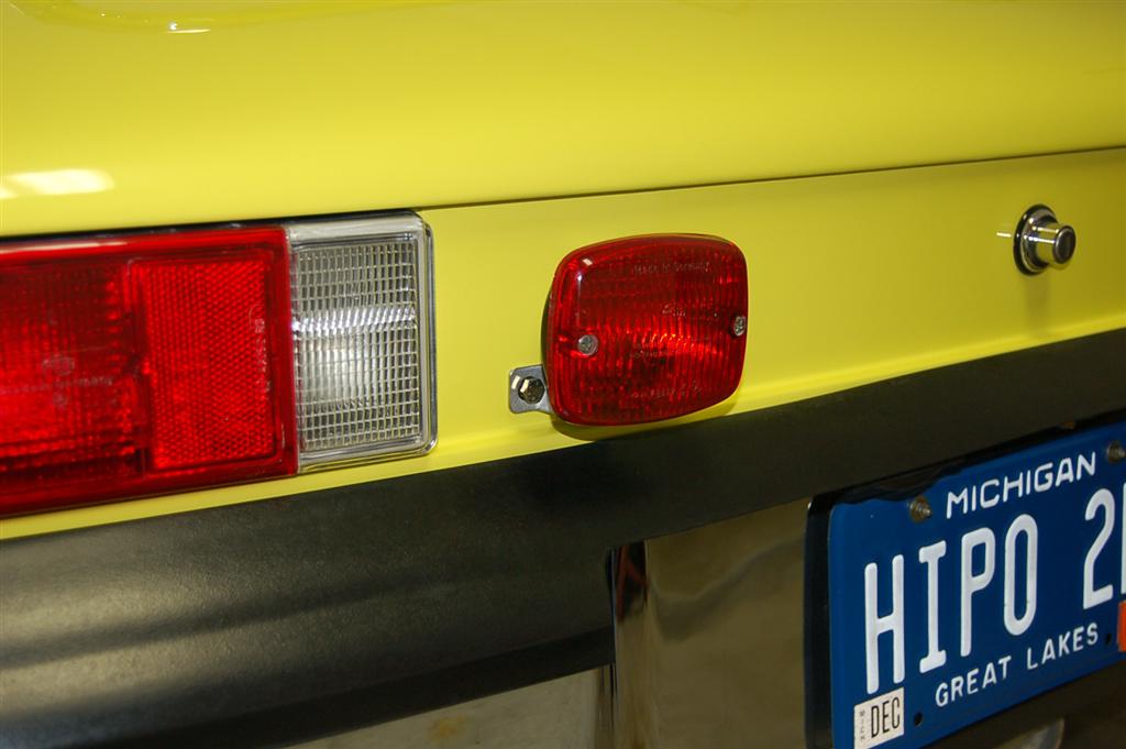

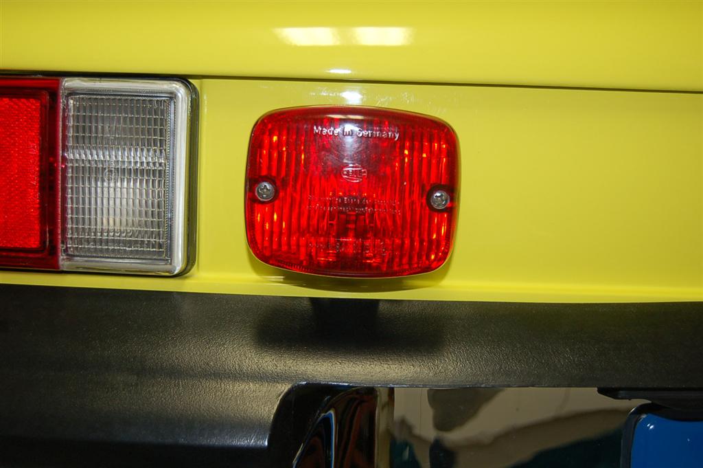

Hi Guys,
I just finished drilling (2) 6mm holes & (1) 3mm hole in by trunk to mount my "Rear Fog Light" factory accessory. I like it, makes my car different from all the others. (IMG:style_emoticons/default/pray.gif)
Here's a few pictures to show details of the U.S.A. issue rear fog lamp I installed. I got a Euro fog lamp assembly from Gustl (thanks Gustl-aka-Wolfgang) & put everything together using the satin black U.S. housing with the Euro lens because I thought it looked better. One of the brackets to mount is still available from Porsche, but the exterior bracket is NLA. The exterior bracket I got from Gustl was a surprise, it's made of stainless steel.
I'll post a number of photo's in a few days showing lots of details & differences. (IMG:style_emoticons/default/popcorn[1].gif) Hope you guys enjoy.
Tom

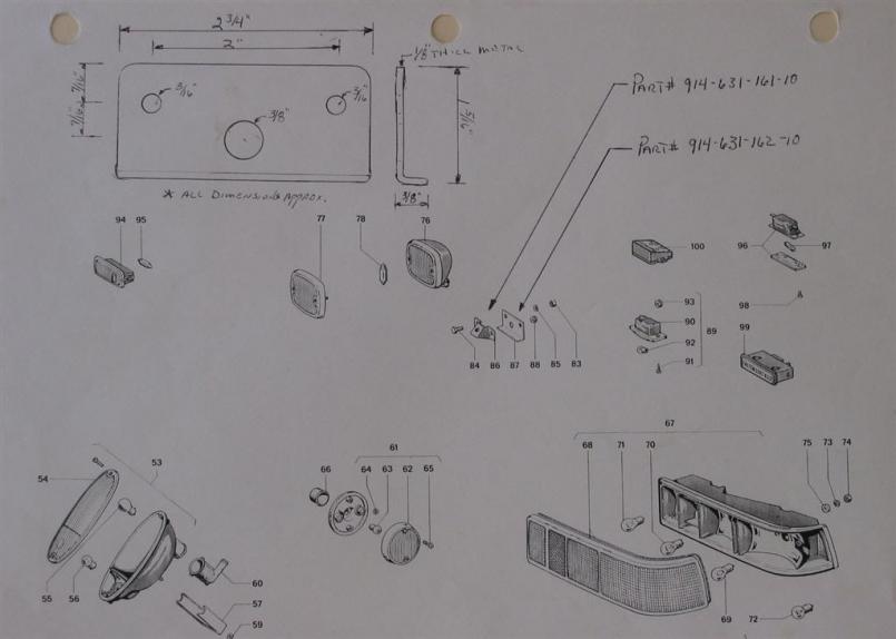

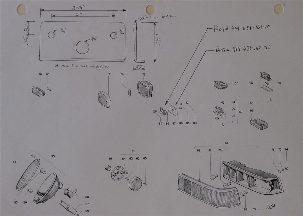

1970 Neun vierzehn   Tom, Nice tidy installation. I presume that there...   Jun 30 2007, 05:06 PM
Thomas J Bliznik   Tom, Nice tidy installation. I presume that ther...   Jun 30 2007, 05:10 PM
1970 Neun vierzehn   Tom, I'd guess that a European wiring diagram...   Jun 30 2007, 05:18 PM
Johny Blackstain   I would also presume that the bulb used in that ...   Jun 30 2007, 05:22 PM
