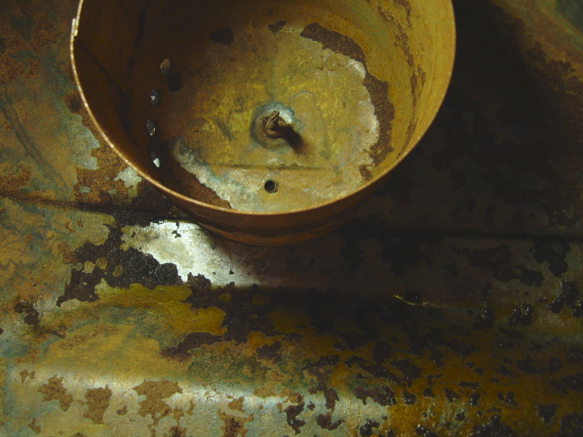

Well I bought the muriatic acid and I've got a can of dad's old nuts (IMG:style_emoticons/default/av-943.gif) , the uncoated, hardened steel ones. So I'm going to do my rattle nut dance (IMG:style_emoticons/default/mueba.gif) (with the tank dry) and see how much (IMG:style_emoticons/default/stromberg.gif) that gets out, I like the chain idea too (IMG:style_emoticons/default/idea.gif) . Then I'll use the acid/water (IMG:style_emoticons/default/stirthepot.gif) to rinse and get out all the crap and see what it looks like. (IMG:style_emoticons/default/cool_shades.gif)
Another thing, what about the little strainer sock? Can I get another, do I need to clean it (non-buyable) or what? |

I've bought the sock at a bug shop before. But that was a couple years ago. Check availability before trashing. (IMG:style_emoticons/default/wink.gif)

Here we go again... Take it to a radiator shop and spend $35 to have it boiled, or otherwise tanked with a suitable alternative. If you have a shop with an ultrasonic tank you won' t believe how good it looks when it comes back. They know their business and you won't torch your digits with acid. (IMG:style_emoticons/default/agree.gif) |

well I didn't (IMG:style_emoticons/default/blowup.gif) and I'm ok (i guess it was that chem lab last year that taught me not to mess with acid).
I put a bunch of nuts in there (IMG:style_emoticons/default/w00t1.gif) (IMG:style_emoticons/default/w00t1.gif) (IMG:style_emoticons/default/w00t1.gif) and did my dance (IMG:style_emoticons/default/dance.gif) and then I did a bath of diluted acid (IMG:style_emoticons/default/stirthepot.gif) and then a water rinse and then another acid (IMG:style_emoticons/default/stirthepot.gif) and another water rinse and then ran the shop-vac on blow to dry it all out and this is what it now looks like... Attached image(s)

Let the acid sit in there for longer to get the stubborn bits. How long did you leave it in the first two times?

I did a fair bit of sloshing, but it was in there like 10 min, you suggesting more an overnight type deal?

Like I said, take it to a rad shop, pay the man $35-50, forget about all of the coating crap, paint/powder coat the exterior, fill it with gas and go for a drive.

That would be a good title for another volume of my threads, but I'll check out getting it hot-dipped or cleaned tomorrow morning. So it's all bare metal when I get it back? and I just paint the outside and leave the inside bare and use it like that? Yup. Opinions differ on coating the inside of a fuel tank. You can coat the inside if you wish. I never will and I've done a couple of 30+ year old tanks. Just let the rad shop do their job and then take care of the outside and you're done. |
