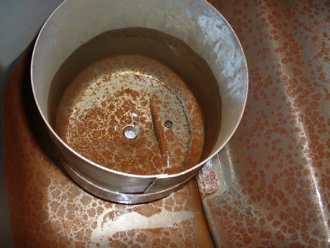

Took out the gas tank and it indeed is full of (IMG:style_emoticons/default/stromberg.gif) . I'll let the pics tell the rest:
BahnBrenner914   Pulled the tank Vol V   Jul 2 2007, 10:06 PM
BahnBrenner914   The tank:   Jul 2 2007, 10:07 PM
BahnBrenner914   The gas from the bottom of the tank that didnt syp...   Jul 2 2007, 10:08 PM
BahnBrenner914   and inside the tank (if you have small children in...   Jul 2 2007, 10:09 PM
McMark   Yup, not surprised given the issues you've bee...   Jul 2 2007, 10:31 PM
BahnBrenner914   Thats a reflection, not a hole. But it is chock fu...   Jul 2 2007, 10:38 PM
McMark   Get a couple gallons of Muriatic Acid and CAREFULL...   Jul 2 2007, 10:40 PM

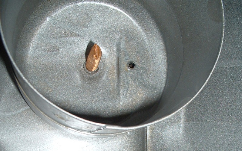

jk76.914   I did the POR-15 route. Here's the before and...   Jul 4 2007, 03:26 PM
ammason   I did the POR-15 route. Here's the before an...   Jul 4 2007, 04:11 PM
jk76.914   I did the POR-15 route. Here's the before an...   Jul 5 2007, 07:35 PM

BahnBrenner914   Well I just finished the last of my acid with the ...   Jul 9 2007, 07:41 PM

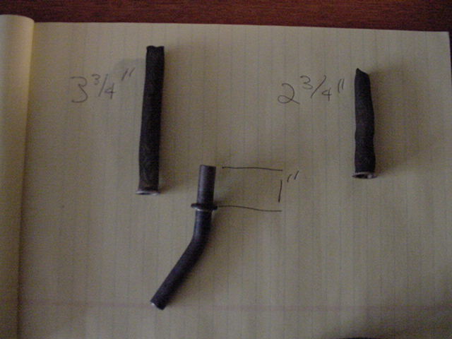

BahnBrenner914   I went and got a new strainer sock for the tank...   Jul 10 2007, 08:17 PM
BahnBrenner914   So the tank is all cleaned out :stir: and I inst...   Jul 15 2007, 11:26 PM
