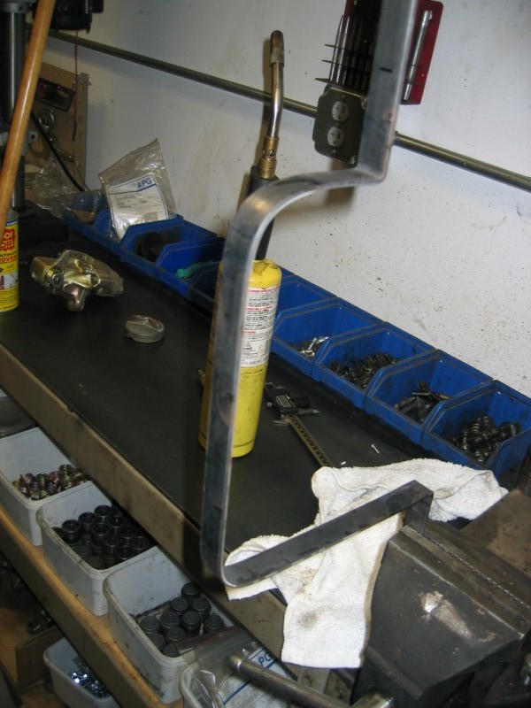

I finally had a few hours to spend on my project (it's called waiting for plating... when the calipers are at the platers and everything is caught up I can actually do something on my car). (IMG:style_emoticons/default/w00t.gif)
Bend, bend, cut and weld. What will it become?

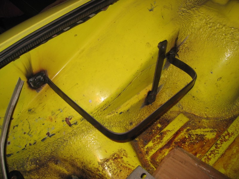

This ought to look a little more familiar for those who know what these are. All welded in. I'll cover with the seam sealer and spray with the re-spray of the trunk.

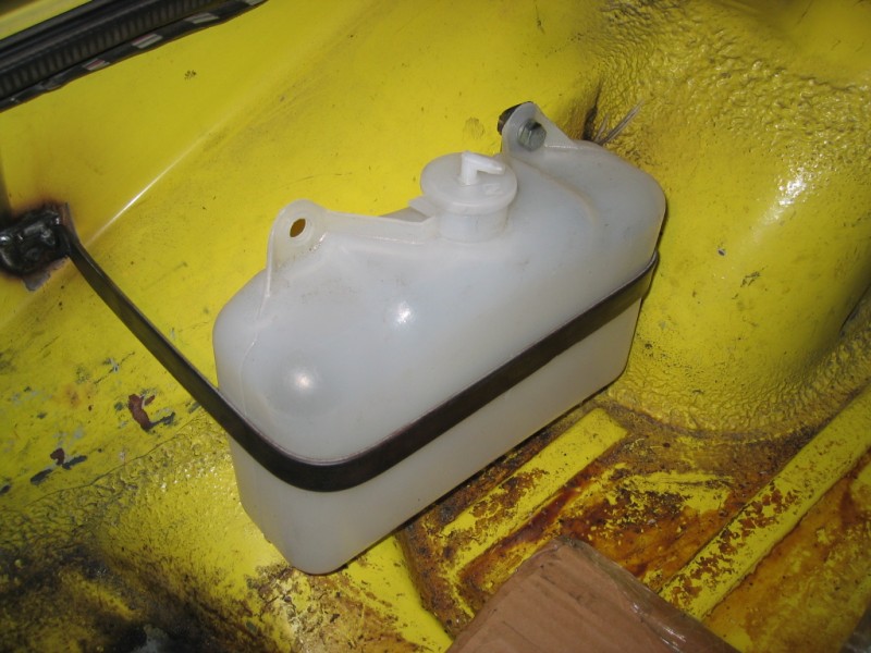

This tank cost way too much money. I feel stupid for buying it but... what's done is done. GT catch tank is finally mounted.

Hey Eric, you can get a Peterson tank pretty cheap.
GT's didn't have those silly polished things... they had these! (IMG:style_emoticons/default/biggrin.gif)

Super cool -
What is the tank originally out of?
Eric_Shea
post Jul 13 2007, 03:42 PM
PMB Performance
Posts: 19,304
Joined: 3-September 03
From: Salt Lake City, UT
Member No.: 1,110
Possibly a very early 911 (65-66) but I've yet to find a source.
