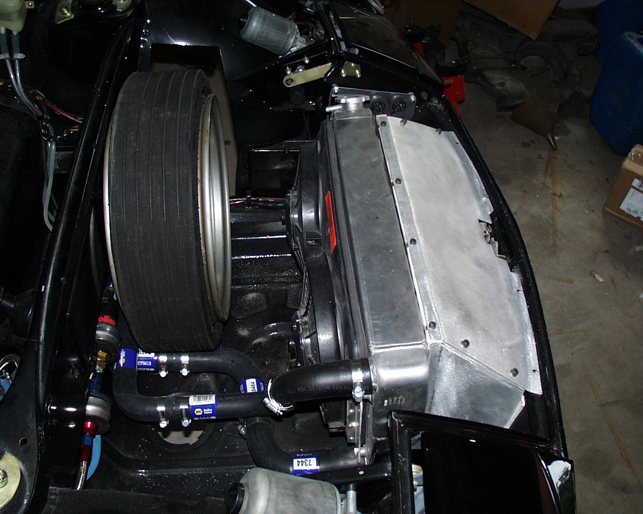

Mine is a custom made dual pass unit, cost me 275 bucks, no problems with heat for 2 years now.
Mark
(IMG:http://inlinethumb61.webshots.com/4988/2033403670057582025S500x500Q85.jpg)

I enjoy looking at all of the monster holes you guys had to cut in your wheel wells to let all that hot air out. Please post more pics like that. Looks like a lot of hose clamps to try to keep tight too.

I have to agree on the part about the hose clamps, there should only be the ones holding it to the radiator and the one at the rear where it connects to the components. Too many clamps make more chances for failure. Ask Joe Buckle how many we took out of his when he bought it, that car was so screwed up and mickey moused it was pathetic. He has or will be pretty much rebuilding that whole car. This time, he is doing it right however.

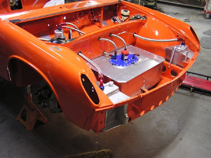

these two?

QUOTE(skline @ Jul 17 2007, 07:06 PM) *
But the choices we have for these cars is growing everyday, I still like the SBC option and I am sticking with it. (IMG:style_emoticons/default/smile.gif)
Yup, as pictured way too many clamps. What I am doing is to mock up a hose from pieces to use as a template to get aluminum tubing bent to match. I am running hard lines under the car that fit into the recesses of the center tunnel.

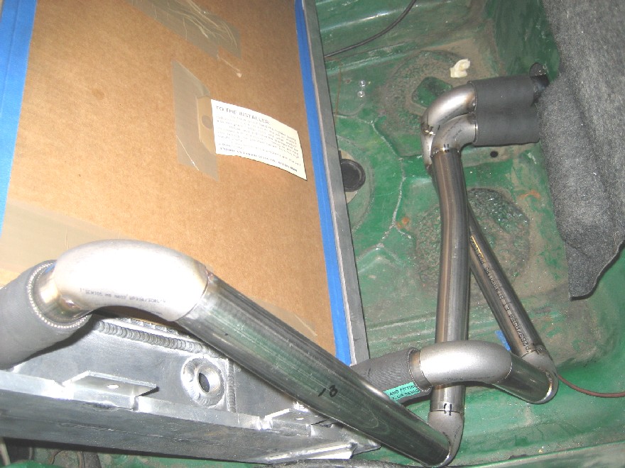

Just a word of caution; Be sure to allow for both expansion of the tubing and vibration/movement allowances. The tubing, especially aluminum, will grow considerably in length and may cause unwanted bind leading to failure. While it is true that the more joints the more potential for failure, the rubber hose will dampen a lot of vibration.
I also did under car hard lines.
Here's a shot of the radiator hard lines done in stailnless tubing (tacked together). Didn't want to, but had to cross them over for best routing.
Andys
