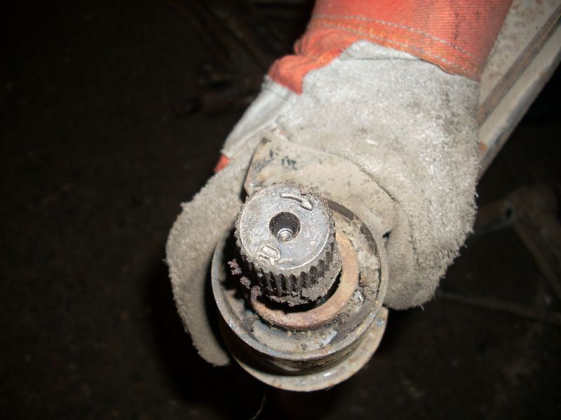

T H O M A S   the /6 drive shaft has less splines,left is /4 ,ri...   Sep 4 2007, 08:25 PM
T H O M A S   /6 cv has a notch ,left is /4 right is /6   Sep 4 2007, 08:27 PM

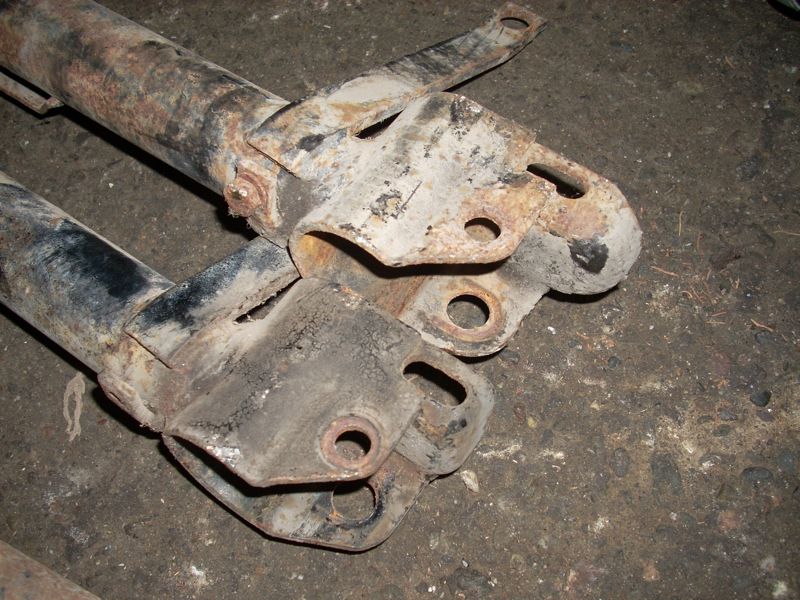

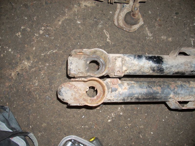

dug   There are some more minor front suspension differe...   Jun 26 2009, 09:55 PM

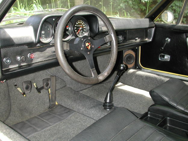

mikez   OK, two questions....leather was the 914/6 dash......   Jul 26 2008, 10:08 AM
Gustl   Also, 15x5.5 inch wheels...what's the stock t...   Jul 26 2008, 10:47 AM
mikey   OK, two questions....leather was the 914/6 dash.....   Jul 26 2008, 11:50 AM
mikez   Yer kidding? That's what they used on the 4.5...   Jul 26 2008, 10:56 AM
Gustl   Yer kidding? That's what they used on the 4....   Jul 26 2008, 12:43 PM

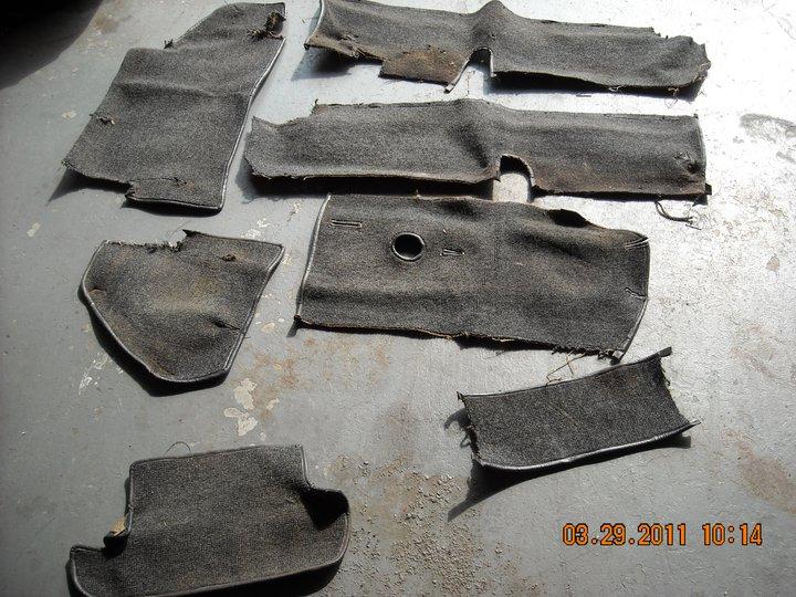

dug   Several have mentioned all the front end differenc...   Jan 22 2011, 10:18 AM
McMark   Several have mentioned all the front end differen...   Apr 21 2011, 04:31 PM
SirAndy   I do! Well, at least the dirty looks the same ...   Apr 22 2011, 03:22 PM
