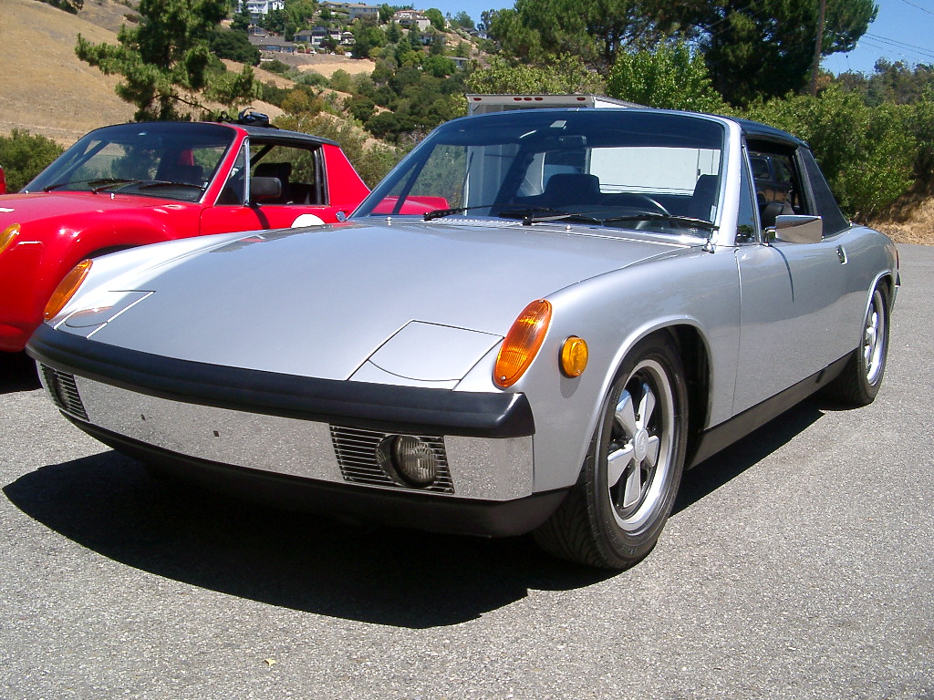

So, after having had the pleasure to drive this beautiful, unmolested, all original, 37k miles 914-6 today, i can't help but wonder if we should attempt to list all the differences between an early /6 and early /4 in terms of originality.
I believe it would be of tremendous help to have a list of things "to look for" when doing a PPI on such a time-capsule.
What do ya'all think?
Andy
Jul 22 2007, 06:40 PM
i'll start ...
- it should have a flat /6, 2.0L motor (doh!)
- firewall center engine mount
- no /4 mounts
- factory oil-tank
- different relay board
- "hook" for the oil-line on drivers side rear long
- 911 style ignition switch and column for '70/'71 models
- *no* hole in the front trunk for the /4 air hose to the spare tire
- black "tar" around the front upper shock towers
- different windshield washer bottle
- electric washer pump
- real 5-lug axles
- "914-6" badge
- handthrottle in front of the shifter
- different throttle cable routing, using a tranny mounted pivot
- different paint code on the karman badge
- different VIN, starting with "914" (doh! again)
- no rain-tray under engine lid.
- Dash top has no center vent
"dogbone" pass. side footrest (did early /4s have those too?) - Yes
different center console (did early /4s have those too?) - Yes
what else?
Andy

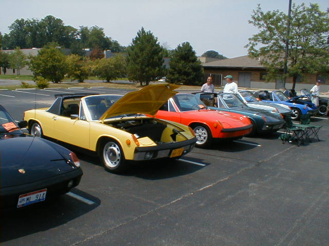

Jul 23 2007, 08:50 AM
Steel wheels Yellow 914/6-1970
Click to view attachmentGary
