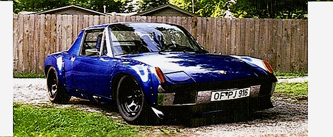

BTW, that car (IMG:style_emoticons/default/agree.gif) belongs to Brett W.
Or how about this one....does it belong to anyone here?

The white one is Scott Schroeder's car. He's on the board.

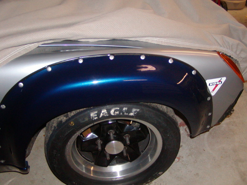

Hi All -
I unfortunately do not have pics on my office computer, I will post some this evening.
Mine are bolt on - no rivets. The gasket I used between the flare and the body is a "heavy duty" vw bug fender gasket. The heavy duty moniker gives toy a bigger bead. They were super cheap - like 10.00 for the whole car. The flares use a stainless rounded button head phillips machine screw on a hard rubber washer. Undernieth is a small fender washer and nylock nuts. This was what the guys at Better Bodies told me they were using on their GT2 body kits. I did mine this way as I loved the look of the old 934, and I simply dont trust the adhesives in terms of future cracks (we had a 70 degree temp swing here in less than 6 hours - and that is not uncommon). I have had them off several times - it makes strut/shock and brake work SO easy.
Sorry for the delay - again, check back later tonight tomorrow.
Scott S
Scott S
post Dec 17 2003, 11:14 AM
Small Member
Posts: 1,698
Joined: 30-April 03
From: Colorado
Member No.: 633
Here is the tops - kind of a distant pic. More tonight....

QUOTE(Scott Schroeder @ Dec 17 2003, 09:12 AM)
I did mine this way as I loved the look of the old 934...
Scott, thanks for the info
(IMG:style_emoticons/default/agree.gif) Totally! The "bolted-on" treatment looks so business like (IMG:style_emoticons/default/aktion035.gif)
I like the idea of being able to remove for brake/suspension maintenance..
Did you use the "flared" rockers as well? Where did you purchase your flares? The prices at www.rennspd.com seem very reasonable. Anyone have experience w/ them?
Did you have to do any trimming on the fiberglass or just prep/paint & bolt-on?
I'd like to see some close-ups of the rocker/flare interface
Thanks!
BH
