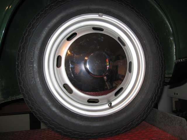

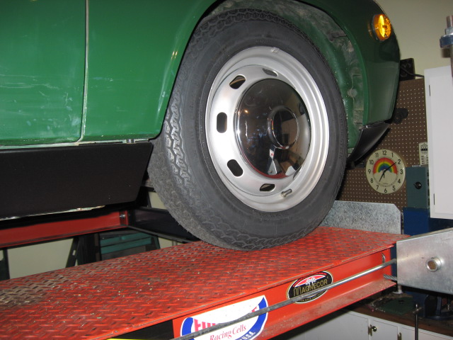

My car is not a concour candidate, but here's my 155SRx15 Vredensteins installed last week. $84 each plus shipping and mount balance.

"Vredestein was not an O.E. manufacturer, and would not be a period correc tire for car shows." - Robert Montgomery, Lucas Automotive
I'm getting some prices & additional info. from him on 165HR15s of various brands, which I'll post when I get them back from him.
Here's another matter to ponder for the CWs out there: (IMG:style_emoticons/default/smilie_pokal.gif)
Both the currently available Pirelli CN36 165HR15s & the Michelin XAS 165HR15s are TUBE-TYPE tires - NOT tubeless as OE on 1973+ 914s (& perhaps earlier too) - so they're really NOT the proper OE tire for 914s either!!!! (IMG:style_emoticons/default/dry.gif) ...plus they're extremely expensive for a set of 4-5!!!! (IMG:style_emoticons/default/sad.gif)
Porsche (& VW) came out with the then "new" 5.5J x 15 rims & alloys in model year 1973 (1972) specifically for tubeless radials, so I doubt that I'd want to take a step backward from 1973 technology today to tubes!!!! (IMG:style_emoticons/default/blink.gif)
I also question the judging logic of PCA deducting points for the wrong make tire in the proper size & tubeless type, while not deducting points for the improper tube-type tires in the proper size/rating & period or repro maker. (IMG:style_emoticons/default/confused24.gif)
It would seem that PCA etc. should make allowances for the time when actual OE maker/size/rating/type tires are NLA at all, but repros like the Vredstein "Sprint Classics" are available! (IMG:style_emoticons/default/confused24.gif)
I've never shown my 914, but I've read some of the PCA's CW rules - & they both expect correct maker, size/rating & type of tires on the car, & expect you to drive the car to the events & in the Parades - for the maximum points to be achieved!
So - since they're NLA in 165HR15 tubeless radial by ANY of the OE tire manufacturers of the period, that only leaves driving on an extremely old & absolutely unsafe set of 32-40 year old tires on a 914!!!! (IMG:style_emoticons/default/yikes.gif)
Are those PCA "Rulemakers" Nucking Futz!???? (IMG:style_emoticons/default/confused24.gif)
...or just completely out of touch with reality & safe driving, or mentally challenged or something??? (IMG:style_emoticons/default/wacko.gif)
(IMG:style_emoticons/default/confused24.gif) Is there a way to petition PCA to instead accept & score based upon the closest combination(s) of the currently available OES/OEM/period/repro makers' features of: brand/mfgr. name, tire model/name (e.g.: Dunlop's SP57, Pirelli's CN36, Michelin's XAS, etc.), size/speed rating &/or tube or tubeless type - since nobody can do them all with a safe tire today?? (IMG:style_emoticons/default/confused24.gif)
...in other words: PCA would score for the best combination of those factors & features, with the adds/deducts for each category under tires?
...for example:
A tubeless Vredestein "Sprint Classic" 165HR15 radial would lose 1 pt. for being a non-OE maker/mfgr/brand,
while a tube-type Pirelli CN36 or Michelin XAS in 165HR15 would lose 1 pt. for not being tubeless,
- thereby BOTH are equal in points, period correct & are safe to drive! (IMG:style_emoticons/default/driving.gif)

I will only echo points that I've made in the past.
You can not put "real" CW tires on an early 914 without giving up safety & handling. I still have my original Continental tube-type spare. Holds air, but only until the tibe expires. Wouldn't trust it for eve a 100 mile trip.
Vredesteins were NEVER an original US spec 914 tire.
Yep, you can get XAS's, with tubes, from Coker. Yep, they'll appear original for a four. Yep, they'll cost you 2 grand to get installed (total). Yep, they'll handle just like they did in the early 70's, which is why everyone dumped them. Yep, you can say similar things about XWX's for sixers.
I'm a diehard CW, but when it comes to safety, it's time to rethink. Yep, you'll get gigged at a major show for the tires, but at least you got there & can get back home.
Pat

So Pat - you're a PCA member & respected multiple concours winner (IMG:style_emoticons/default/smilie_pokal.gif) - can't you & others of your stature in PCA petition for some sort of a more sane rating system, such as what I'd suggested above for tires? (IMG:style_emoticons/default/confused24.gif)
[/quote]
Chuckle here!
Look, I first noticed that something was wierd about tires for PCA Parade purposes in '93. That was the year I chaired the Parade Concours.
As you might expect, I'd spent over a year in prep for the event & couldn't enter my own car (well it just didn't seem right to do so). But I noticed way back then that entrants were being slaughtered for not having "original" tires.
I was amzed at how many Porsches were whapped for major points because of unoriginal tires. Many competitors lost solely on tires. Set me to thinking.
Tried to make the point with the Parade Concours Comitte that tires were a "safety" thing and should be thought of as the relief given to early 911 owners who had hydropneumatic struts( which were given the OK to substitute). Fell on deaf ears. Two members of the committee ruled me out as a crackpot. The third admitted that I had concerns, but was ruled by the rules. That was 2 years ago. I gave up up after several unanswered appeals.
One one hand I can see the concerns -maximization of purity. Hard to argue with.
On the other hand, I feel that safety should be paramount over originality (yeah, I know...).
I would only suggest tht a grass roots movement be started to change this absurd rule. Be happy to apply my name.
Pat
