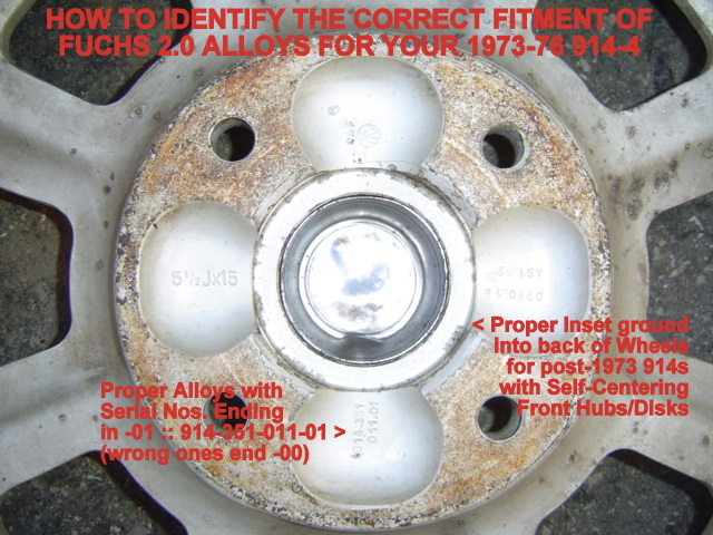

THIS SHOWS THE "CORRECT" INSET AT THE CENTER OF THE BACK OF FUCHS ALLOYS - WHICH SHOULD ALSO BE ON ALL WHEELS FOR 1973+ 914s WITH THE SELF-CENTERING FRONT HUBS:

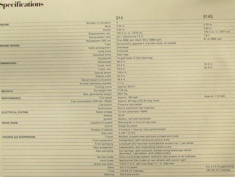

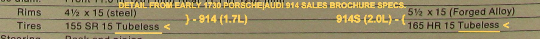

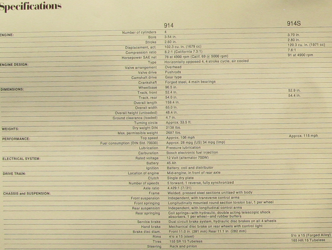

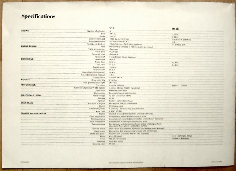

TIRE FITMENT FOR 914-1.7 & "914S" (914-2.0) FROM EARLY-1973 MY PORSCHE|AUDI SALES BROCHURE

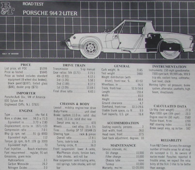

SEE NEXT 2 POSTS FOR THE MT & R&T ROAD TEST SPECS WITH OE TIRE INFO.....
Tom_T
post Jun 11 2009, 12:20 PM
Post #204
TMI....
Posts: 8,321
Joined: 19-March 09
From: Orange, CA
Member No.: 10,181
"914/S" (914-2.0/"914S") TIRE FITMENT AT SPECS FROM 2/73 R&T ROAD TEST ARTICLE

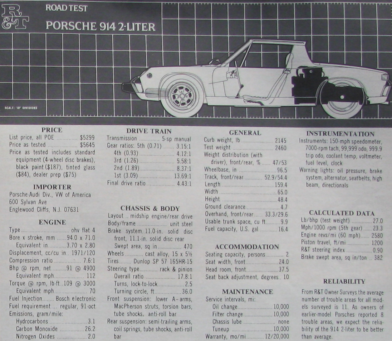

...see MT 1/73 at next post....
Tom_T
post Jun 11 2009, 12:21 PM
Post #205
TMI....
Posts: 8,321
Joined: 19-March 09
From: Orange, CA
Member No.: 10,181
"914S" (914-2.0) TIRE FITMENT AT SPECS FROM 1/73 MT ROAD TEST ARTICLE

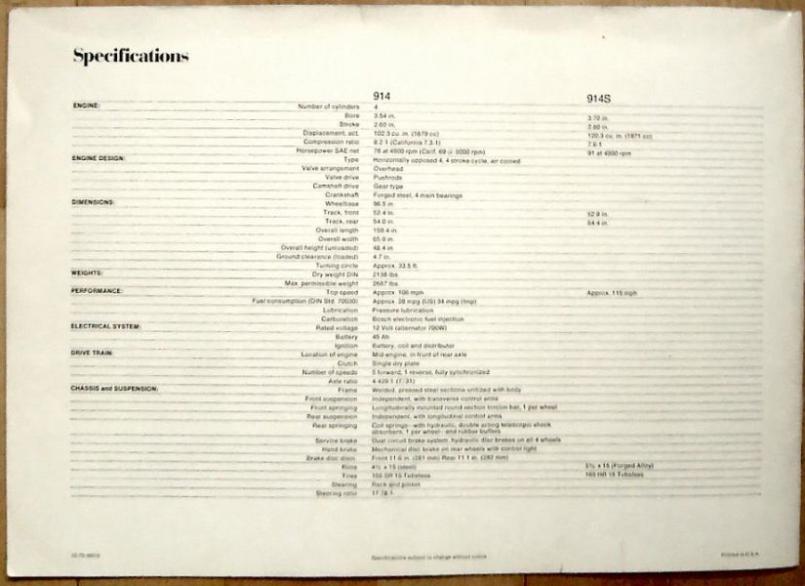

> Note that Porsche|Audi's early-1973 MY 914 Sales Brochure's Specs on the 4th pg. which I posted earlier in this thread a few up - Specifies either 155SR15 Tubeless (914 with 1.7L) & 165HR15 Tubeless (914S with 2.0L).

With regards to "J" wheels - what I've read that they were new for the 914/4s in the 1973 MY - corresponding to the use of Tubeless Radials (instead of tube-type as in prior MYs). The 914-6s may have been a different matter, since they utilized the 5-Lug Porsche wheels, and you 6ers would know more about that aspect than I! (IMG:style_emoticons/default/unsure.gif)

I do have in my possession - an actual hard copy of the bigger/longer 12pg. version of that early-1973 MY PORSCHE|AUDI 914 sales brochure available at their dealers, which has the same front cover & back cover with the Spec. Sheet, as well as all of the information of the 4 pg. one (albeit in a different layout) - as well as additional information & pix. That 12 pg. brochure is also available at the 914 SIG webpage below, but the 4 pg. one has more legible pages linked thereto. I've supplied Jeff Bowlsby with better pix of my 12 pg. brochure, which I'm sure he'll post there too/instead, when he gets a chance.
Below is posted a detailed pic form my 12 pg. Brochure which clearly states the wheel & tire fitment as Factory OE for both the 914 (1.7L) & 914S (2.0L) Models of the early-1973 MY. Additionally, the bottom of both the 4 pg. & 12 pg. Specs. have the disclaimer that they can change the specs. at any time without notice.
THE EARLY-1973 914 BROCHURE'S SPEC. BELOW -I WOULD SAY THAT THE ONLY TOTALLY CORRECT TIRE FOR 914S OF THAT PERIOD WAS TUBELESS:
Detail from my 12 pg. Brochure's Specs. on Wheels & Tires:
Low Rez Front & Back Covers of 12 pg. Brochure from Web Link above:
Given the above, IMHO - I again say that the more appropriate course for PCA et al's CW scoring would be to rate the Tire aspect based upon the maximum number of attributes for a particular model & year garner the best point score in the Wheels & Tires category (but then, I'm not a member). (IMG:style_emoticons/default/smilie_pokal.gif)
IMHO -it would seem an appropriate course of action for those whose 914s Spec'd. Tubeless tires, that they contact Vredestein to see if they can get a letter confirming that they either supplied OES tires to Porsche/VW for the 914s, &/or if they had available in 1970s aftermarket (non-OES) Tubeless Radial Tires in the 914's OE spec'd. size (e.g.: 165HR15 or 155SR15).
