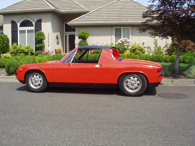

So, it appears an early 4 (MY '70) had 4.5"J wheels with 155SR tubeless tires as my 5/70 production car does. And sixes had H tires with tubes.
I again argue that for any four the Michelin XZX tubeless 165SR is the best and closest option (no 155 available in Michelin XZX). And for cars with 5.5" factory wheels the 165 was correct.
The first optional alloys were 5.5 Pedrinis on the four, for sure available on '71 model year cars. Don't think they existed for '70 and I know they didn't in June '70 when I bought a car and had dealer installed chrome wheels. If factory chrome or alloy had been available I would have ordered them. Rivieras were the first alloy's to be seen on the earliest 914's.

Pedrinis on a two-owner '71 with 20 year old Michelin 165's. I bought it in '02 and drove it from Chicago to Portland, OR. The seller had two of the tires dismounted and "inspected" at a tire shop. Risky trip as I think back on it, snow in Wyoming and 80 mph across Nebraska, but I made it ok. When I sold it a year later the buyer (a senior woman!) flew to Portland and drove it to Maine on the same tires with no tire problems. She might have been Irish!
