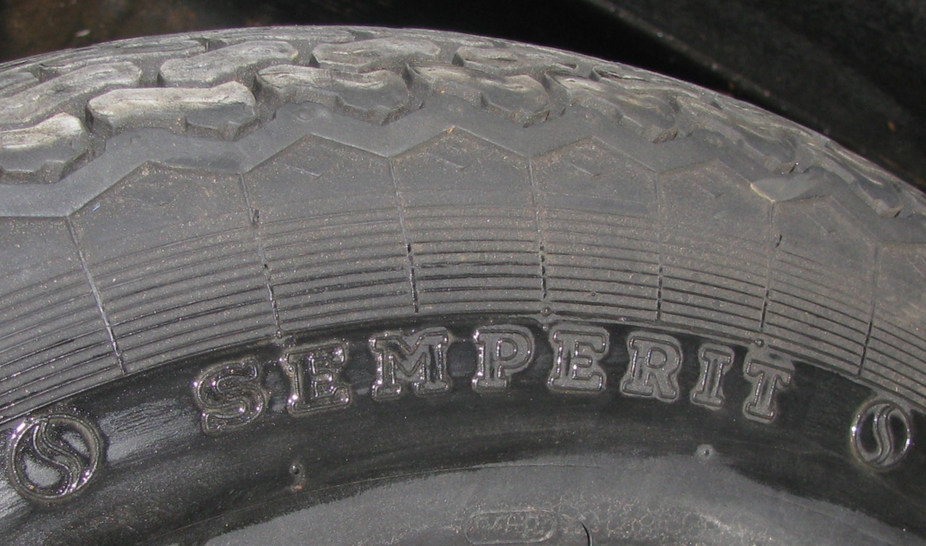

FYI - RE: Semperit Tires being delivered on 914s & Porsches, as quoted on the pages noted from the period auto magazine articles contained within:
"PORSCHE 914 - Ultimate Portfolio", compiled by R.M. Clarke, publ. Brooklands Books Ltd., P.O. Box 146, Cobham, Surrey, KT11 1LG. UK, ISBN 1-85520-4320
- available thru B&N.com, Borders.com, Amazon.com, etc.
BTW - Great Reference! - this is an excellent compilation of many/most of the 914 related magazine articles from the era 1969-1976, as well as some post-era look-back reviews - all compiled within one softback volume. (IMG:style_emoticons/default/biggrin.gif) It sure beats buying used magazines to get each one! (IMG:style_emoticons/default/dry.gif)
Quotes from the above as noted:
"This is a 911T in its normal habitat. Porsche uses little known (in the U.S.) but very excellent Semperit radial tires as standard equipment." - emphasis added
- Photo caption on bottom left, at pp. 111, from: "Porsche" article, "Road Test" magazine, Jan. 1971 (starts on pp. 110)
(IMG:style_emoticons/default/idea.gif) ...and to quell the next anticipated argument against there being any Semperit tires on US sold 914s....
"...The distributor had shown mercy on the test car with a set of wider , 5.5-inch chrome-plated wheels and larger 165 HR 15 Semperit radial tires...." - emphasis added
- Within second paragraph from end of article at pp.73, from: "Porsche 914 Road Test" article, "Road & Track" magazine, July 1970 (starts on pp. 69)
I rest my case - Semperit tires were both used by the factory on all Porsches in the model range during the 1970's, as well as being available here in the USA from the distributors.
Additionally, the changeover to self-centering "hub-centric" front hubs in the 1973 MY initial months, resulted in the BH (Mahle & Pedrini Alloys) & BO (Fuchs 2L Alloys) Factory Recalls, wherein the factory via the distributors supplied the dealers with replacement sets of wheels & tires with the appropriate hub-centric inset machined into the back of the alloy wheels.
Ergo, Semperit tires such as the 165HR15 on my spare in the pic in an earlier post here, was in fact the OE tire for my early 1973 914-2.0 originally sold in CA on 11/9/72 & built in September 1972 - on the new for 73 MY 914 hub-centric "Mag-look" steelie" probably due to dealer theft of the Fuchs spare! And they probably were on some other USA 914s along the way too! (IMG:style_emoticons/default/smile.gif)
These were great handling tires which lasted 40,000 under most driving conditions - even a hard driving 914 or 911, as compared to the far more expensive soft-rubber Dunlop SP57s getting chewed up within 20,000 miles under even easy driving! The road tire tests of the day upheld this fact, with Semperits regularly performing as well or better than the pricier & oft touted Michelins, Continentals, Pirellis & Dunlops, etc., as well as against the USA domestic brands!
Too bad Semperit doesn't export great tires to the USA anymore, although they do still sell them in Euro-Land.
Any Euro-Teeners still using Semperits?? (IMG:style_emoticons/default/driving-girl.gif) (IMG:style_emoticons/default/driving.gif)
...if so, how are they?? (IMG:style_emoticons/default/confused24.gif)

QUOTE(Tom_T @ Nov 1 2009, 04:02 PM) *
Umm, don't think I'd rely on that spare after these many years. Still have my original Conti spare for my 72, which looks great & hold air under no stress, but I'd never put it on the road.
Sorry, never used Semperits. Went from Conti to Pirelli CN36's, which is another story.

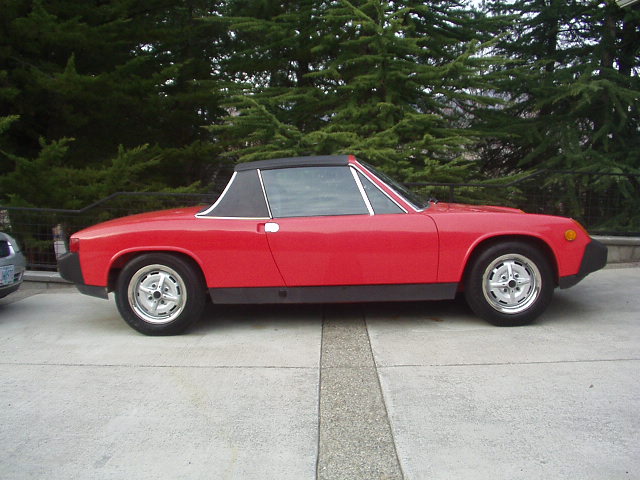

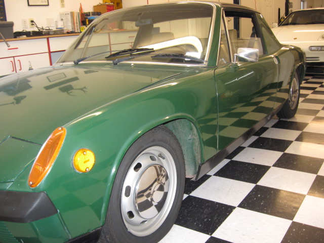

I’m in the process of revitalizing my ’75 2.0 that has been sitting in my garage since the ‘80s (no time or money). The PO painted (and I use the term loosely) the stock steel wheels WHITE. Vintage photos indicate those wheels should be GREY.
My question – what is the correct GREY color?
Porsche Rescue
post May 11 2010, 06:34 PM
Post #269

Best choice is Wurth metallic silver wheel paint topped with their clear. Expensive, but closest to original finish. Comes in spray cans from various online sources.

post May 11 2010, 07:23 PM
Post #271
Saving and Enjoying Old Porsches
Posts: 2,978
Joined: 31-December 02
From: Bend, Oregon
Member No.: 64
He wrote "stock steel" Tom. On a '75 they would have been these.
Wurth silver.

Thanks for the clarification on the wheel color. I did a double take when I saw the picture of the Scarlet Red car pop up. That's probably exactly the way mine would have looked from the factory.
Thanks again.

post May 11 2010, 07:45 PM
Post #273
Posts: 2,978
From: Bend, Oregon
Member No.: 64
The red car has chrome trim rings added. Not stock, but a look I like on the steel wheels. Your wheels came with black plastic lug bolt head covers, in case they are no longer present.

Yes, I noticed the chrome trim rings. Mine do not have the rings, however, all the black plastic lug bolt caps are still present and accounted for. Bought some 4 bolt Fuch's to put on anyway.
